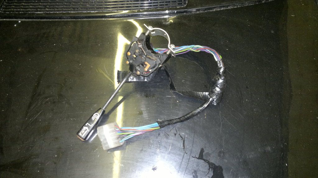

#8 Post by Toledo Man »
Ash, if you have a later type indicator stalk you will also have a wiper stalk. This what mine looks like.
This is the one off my 1974 Toledo.
You can have first dibs. I'll have a look in the loft to make sure I still have it.

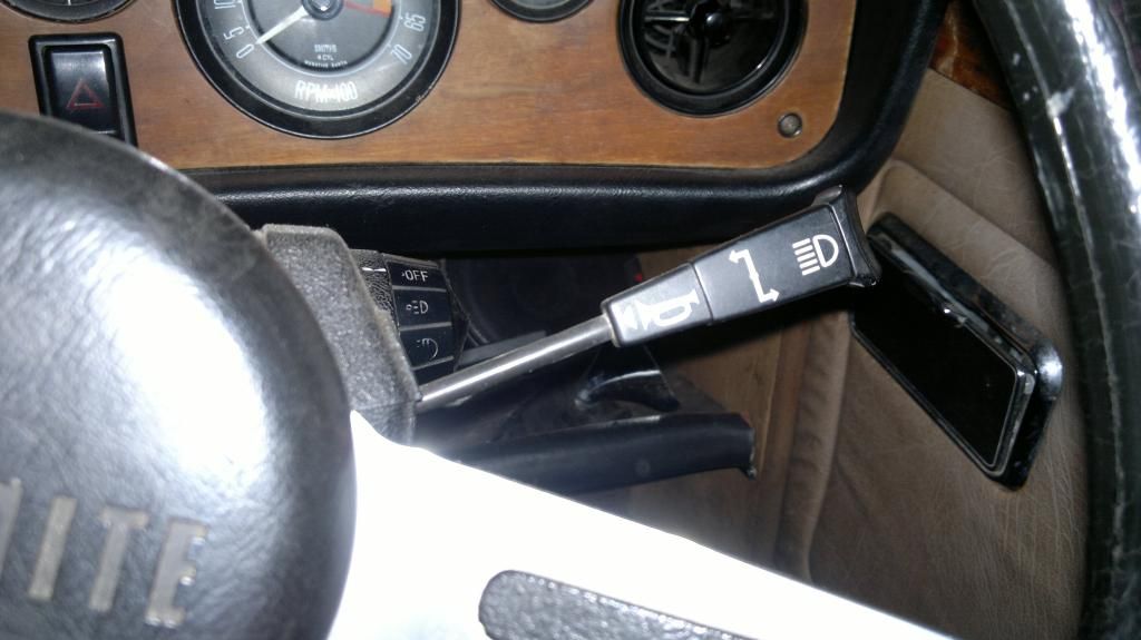

grifterkid
Re: Toledo indicator stalk has crumbled...!!! HELP!
#9 Post by grifterkid »
cleverusername wrote:I'm not sure there is a spring, from what I remember from my old knackered indicator stalk, the springing action seemed to be a combination of the plastic and brass parts, with no spring. However I never had it full apart, so there could be one hidden in there somewhere.
I have tried to put it all back together but there is no 'resistance' at the end and when the plastic part slides down the horn connection is made and the horn ruddy goes off...!!!
With regards to my 'stalk' I have the 1974 type pictures and not the one above it as my wiper controls are on the dash... My indicator stalk is exactly the same as the 1974 one you have there Toledo Man... :wink:

#10 Post by Toledo Man »
I've dug it out of the loft, cleaned it up and replaced the tape. You still have first dibs if you want it.
