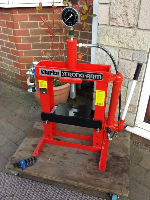

Decided to treat myself to a new toy, a hydraulic press. I opted for the bench mounted one as really the floor mounted one is really rather large. I still need to sort out a bench but in the meantime it's on a skateboard so I can wheel it around and use it, albeit at a low level.
So far seems pretty neat though I am having issues with the pump. With it mounted as per instructions then the ram will move about 5cm and stop. If I remove the pump and place it next to the frame it works fine. No air in the system but most frustrating. I removed a bush in a trailing arm last night and it made a tricky job very easy.

Very trick! Like the pressure gauge on top...
I bought a 12 ton press a couple of months ago - they really are quite reasonable now - mine was less than £80 delivered to the house and I've already done a couple of jobs which I simply would not have been able to do otherwise...useful bits of kit

When you get a bench sorted, make a big hole under the centre of the press. When you want to push a bearing onto a half shaft or similar you'll need the hole to put the shaft through :)

Issues with ram travel now resolved. Made very light work of old bush removal, quite why you'd use a vice is beyond me. Pressing in the new bushes will be fairly easy with any luck.
