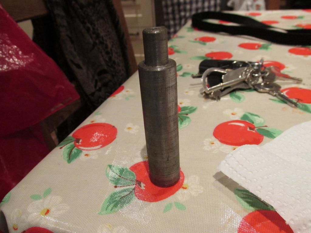

Tony Burd
Posts: 1248
Location: Andover Hants
Re: Sprint - Clutch Alignment Tool
#5 Post by Tony Burd »
Bloke at work turned this up for me from the measurements I gave him, works a treat.
