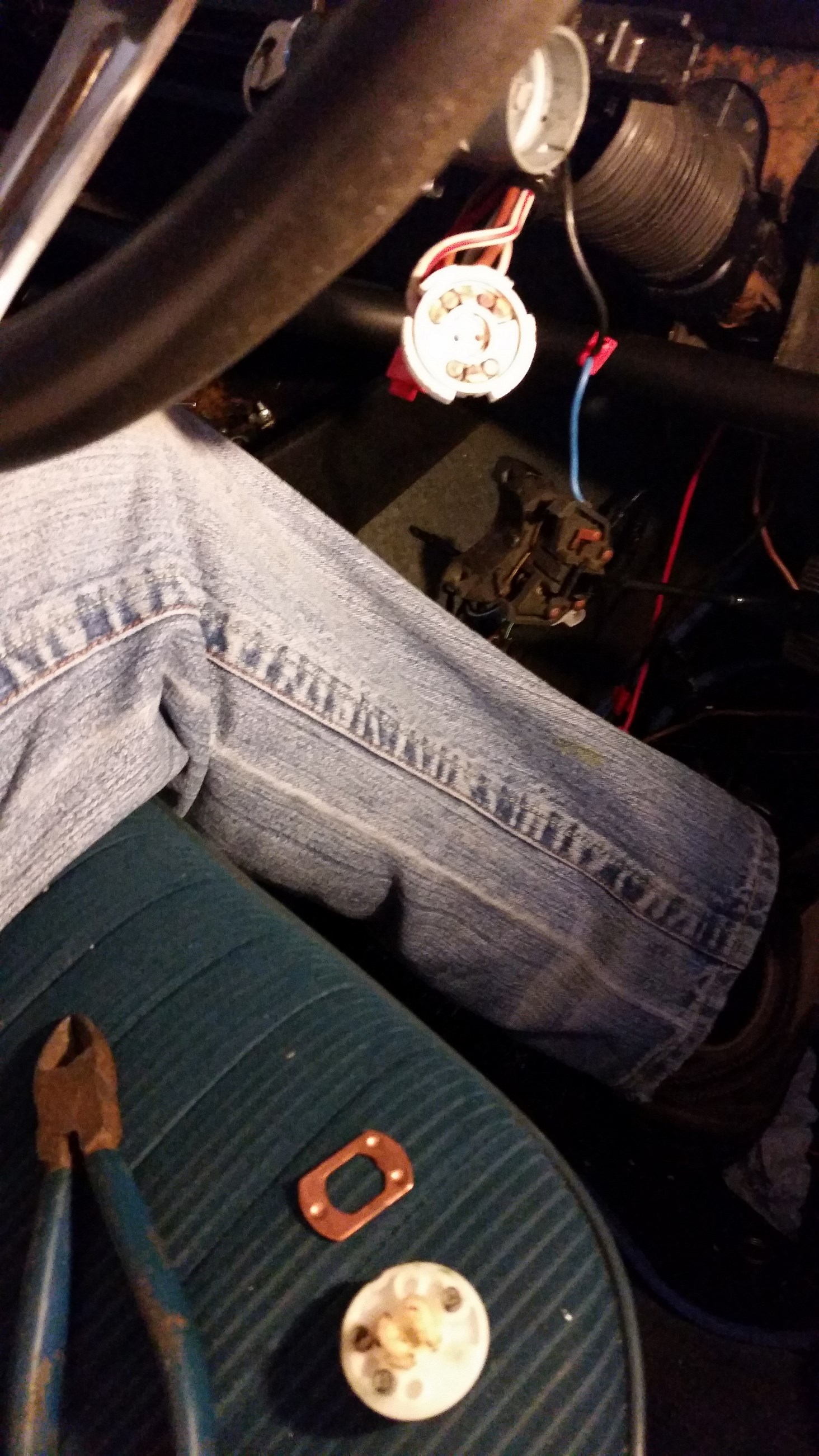

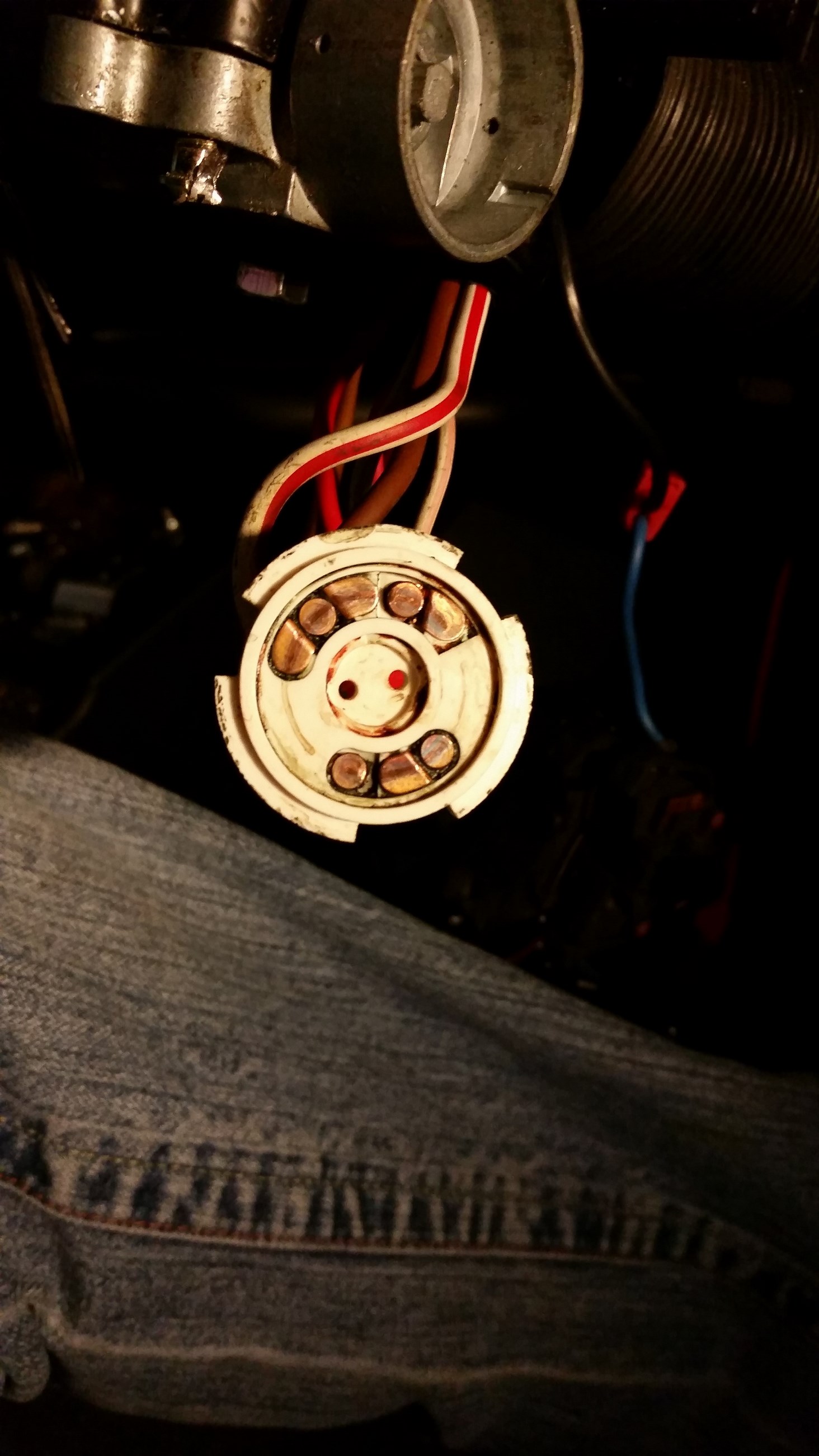

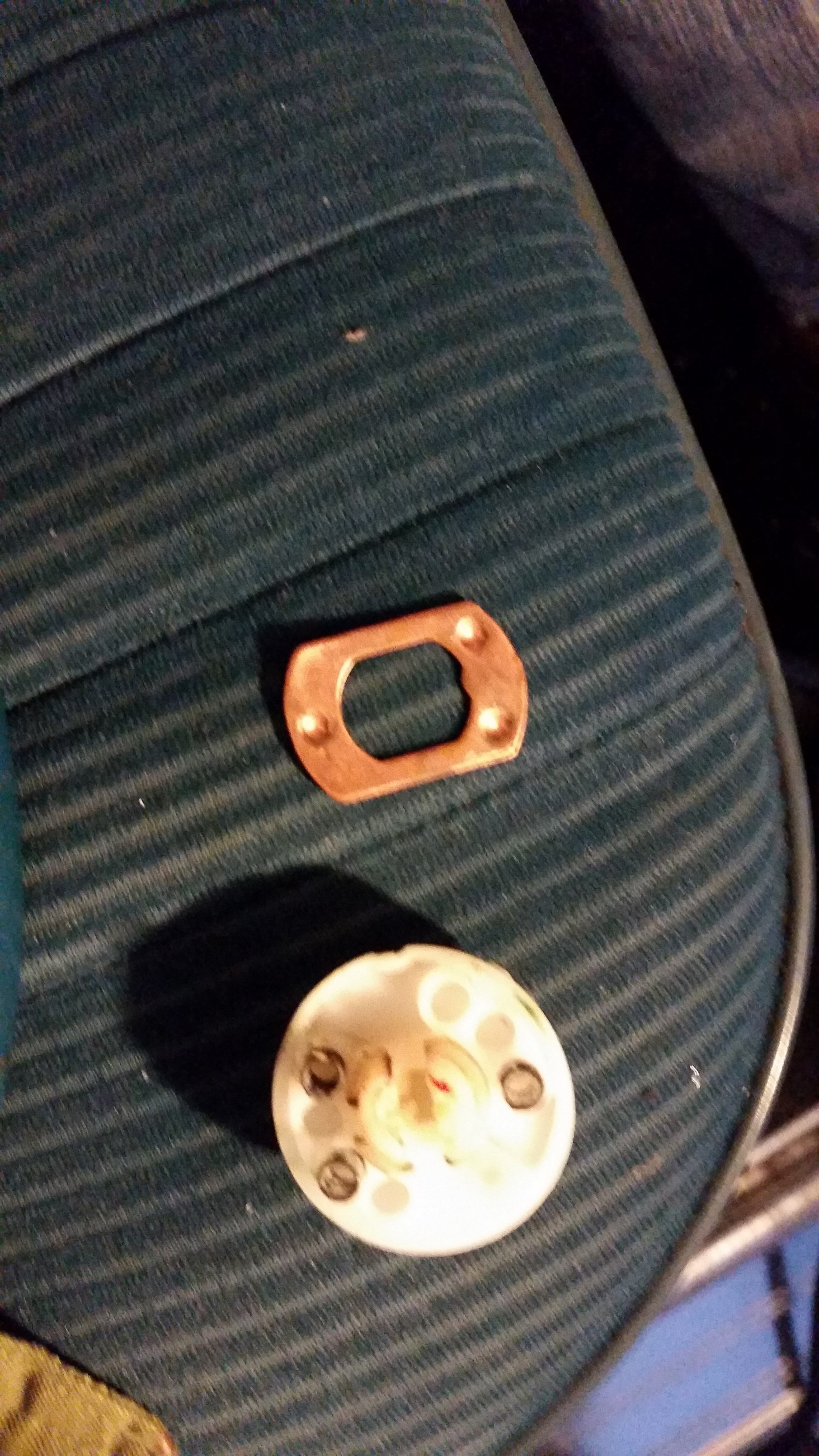

Hi Guys
Cheers find attached some photos of the unit disassembled, is there any diagrams of how to correctly re assemble it, as when I removed it, the unit fell on the floor before I could take photos. I have cleaned all contacts. Just wondering is there an anything I can test to make sure it’s not something else causing the issue? Could I hotwire it?
Derrick
Derrick
