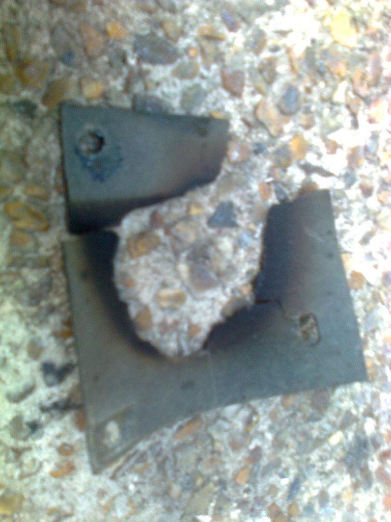

Last night i had a minor fire in the engine bay of my Dolly. Luckily, i got to it before any serious damage was done, but it could have been much worse. Could i please suggest all Dolomite owners take a look at their heater motors in the passenger side rear corner of the engine bay. On the bottom of the motor is a resistor that is switched in and out to give a slow and fast speed. Sandwiched behind it is a piece of fibre board - basically thick card. I think the original purpose of this was to stop you burning your hand on the resistor, and im sure it was treated at the factory to give it some heat proof capabilities, but after 40 years soaking up oil its now a nasty little fire risk.
Remains of mine after the fire:

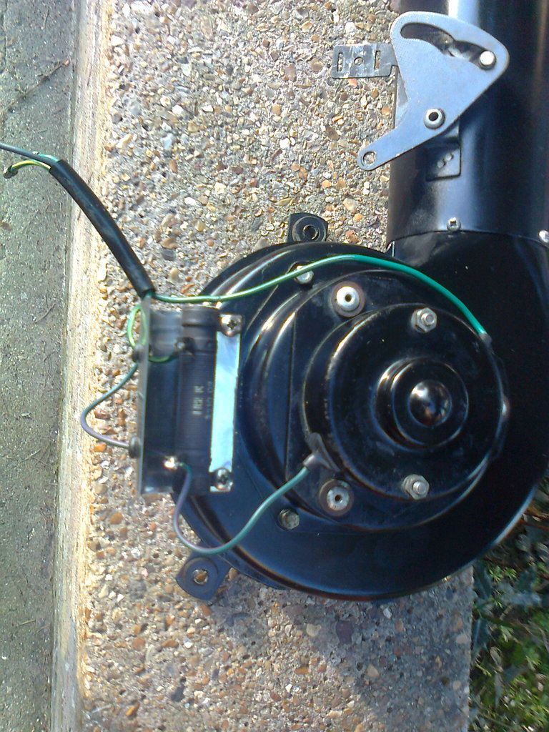

I suggest strongly that this piece of card is removed, and you replace it with something similar in shape made of something that won't burn - i used thin Stainless Steel as i had some left over from a modelling project, but you could use mild steel or alloy. Anything that will act as a heat sink basically. And grommit the wires where they go through the new plate...
Suggested fix:
Thanks - Matt.
