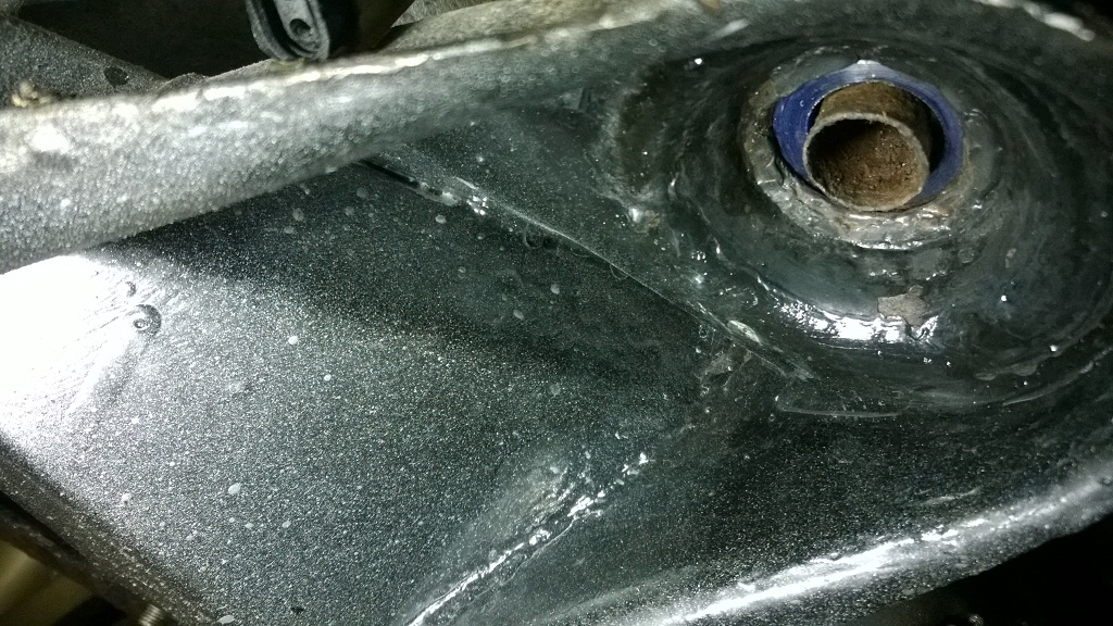

On the OS I have established that the chassis leg does have the protruding tube. See the attached photo. The poly bush remains in place and is in OK condition. The issue is that the tube protrudes about 17-18mm and not the 22mm indicated in previous posts. It's all looking to be in good condition although it's noted that the tube is considerably less substantial than the cut-down spacer tube that will get used on the NS.

- WP_20151115_17_31_51_Pro.jpg (324.42 KiB) Viewed 468 times

The existing tube on the OS doesn’t protrude as far as spec either and was only 17.5mm long. This means you can’t tighten right down onto it without feeling like you are crushing the bushes too much. I went to 30lbft where it looks OK and everything looks similarish to the NS.
