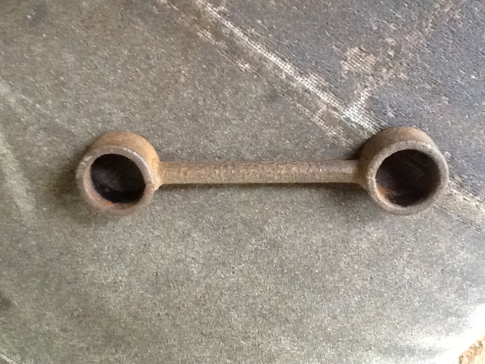

Hello all,
I want to renew the bushes in the link assembly
Any idea were to get them from or what to use
Many thanks
Simon

Any idea where I can get them from ?
Thank you

Sorry, I have no idea where this part would fit. But I'm only into 1850's, no experience with the other familiy members

Henk wrote:Sorry, I have no idea where this part would fit. But I'm only into 1850's, no experience with the other familiy members
Same here, doesn't look familiar.

This is off a Sprint. It attaches to the Load Sensing Valve and the rear axle. Sorry, I don't know where you would get the bushes but would have thought there might be something after market you can use?

Ive got a few shock absorber bushes lying round off various things. Whats the inner diameter?

Measure the hole and get hold of a Rally Design catalogue and find a suitable poly bush and chuck a bolt through it.
Oh the joys of ancient motors :lol:

It does appear from the parts list that the bushes were not sold separately. And I very much doubt the availability of a new link - unless the one that goes with the Hyundai copy of the LSV is the same. I probably have a used link rod here but I haven't inspected it to determine the re-useability of it's bushes.
