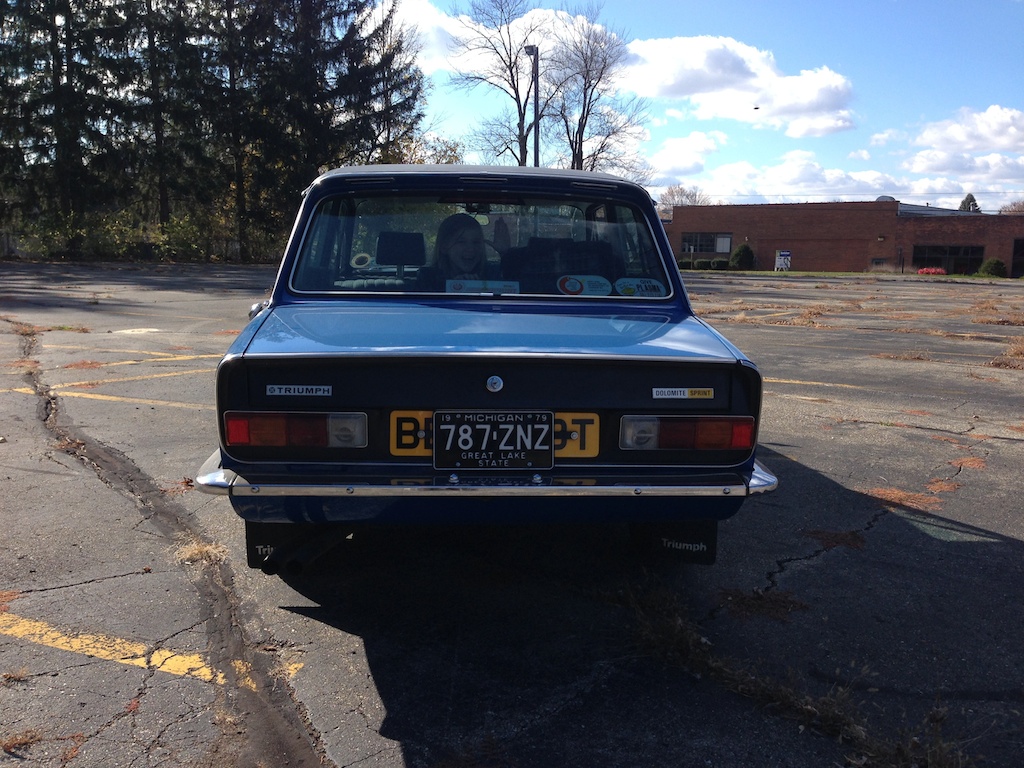

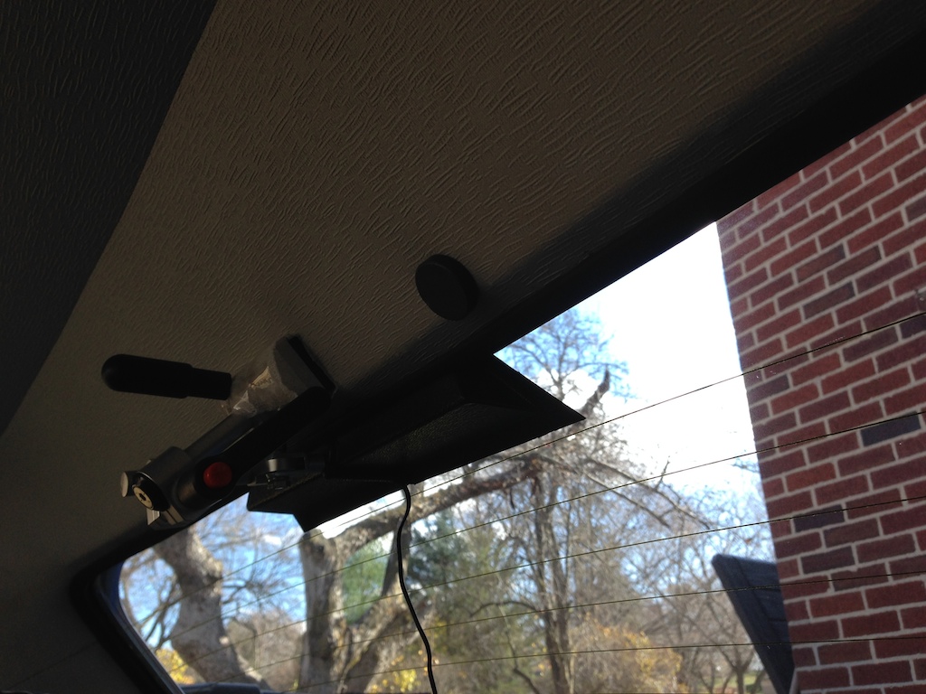

I came up with a solution for this that I’m quite happy with.
I bought the part from https://www.ronfrancis.com/products.asp?dept=25. I got RW-12, with a 30-degree angle to the plastic housing. That part number doesn’t seem to be listed anymore, but maybe they still have it. The wiring was just long enough to reach the brake-light connector in the boot.
The custom mount uses a really strong magnet to grab through the headliner. Then it has an adjustable elbow to connect, via a screw, to the plastic LED housing. I can’t direct you to a place to buy such a setup online, but maybe this will give you some ideas to work with.
In any case, if you mount something on the passenger-compartment side of the glass, you’ll want some sort of shroud housing in order to avoid nasty, distracting reflections while driving at night.

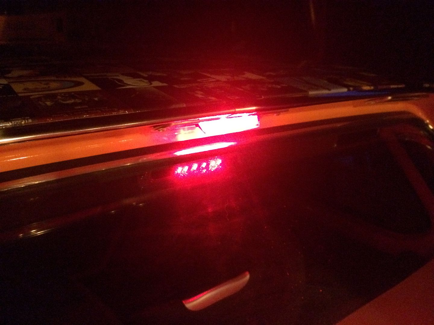

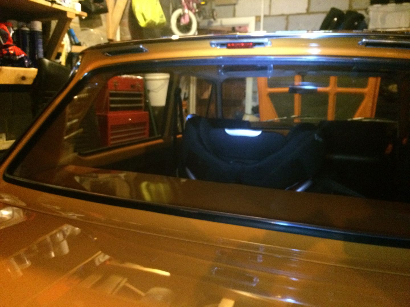

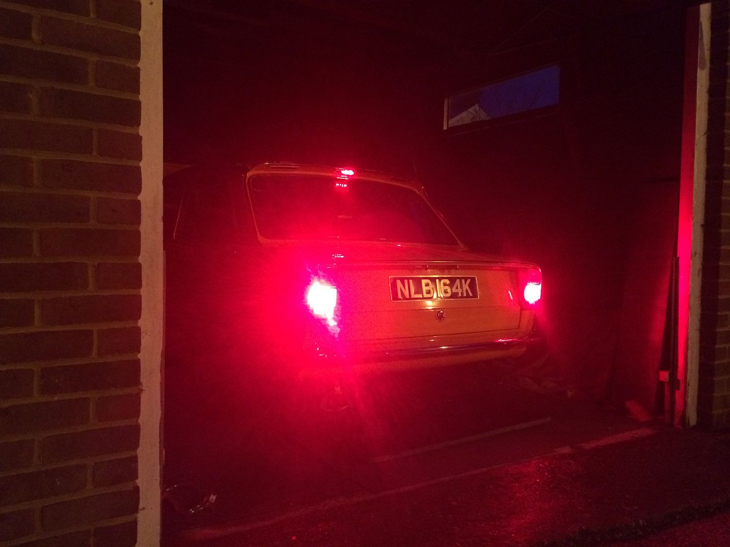

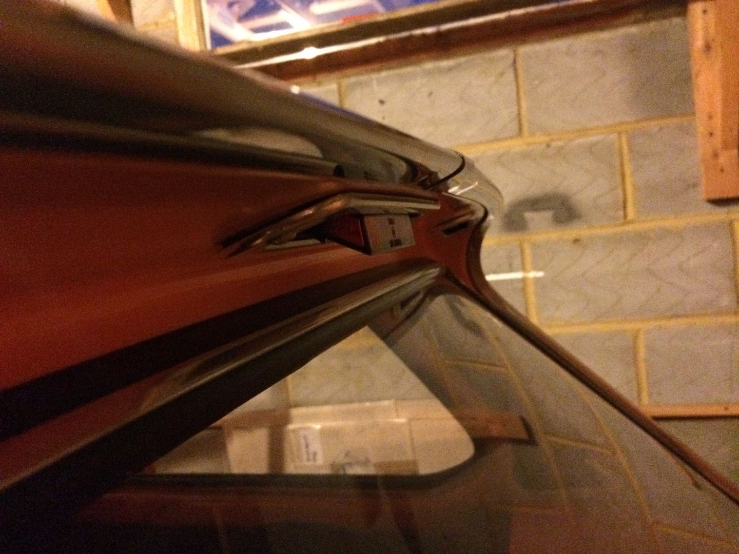

Happy New Year all!
So, I finally got around to tackling this today.
In actual fact it was very simple. I just spliced into the drivers side brake light wire, one live, one for earth. Fed the new wires though the side of the boot, via the inside of the C pillar and fed through to the roof, above the headlining and out of the centre roof vent. Brake light then secured in the vent itself.
It works fine, I think is discreet, and is good and bright (although not as bright as the new LED brake lights which are VERY bright). I'm pretty happy that it will make braking more noticeable.
Total cost, less than a tenner, and probably a 15 minute job once I decided where to fit etc.
Here are some quick phone photos if anybody is interested in doing similar.
