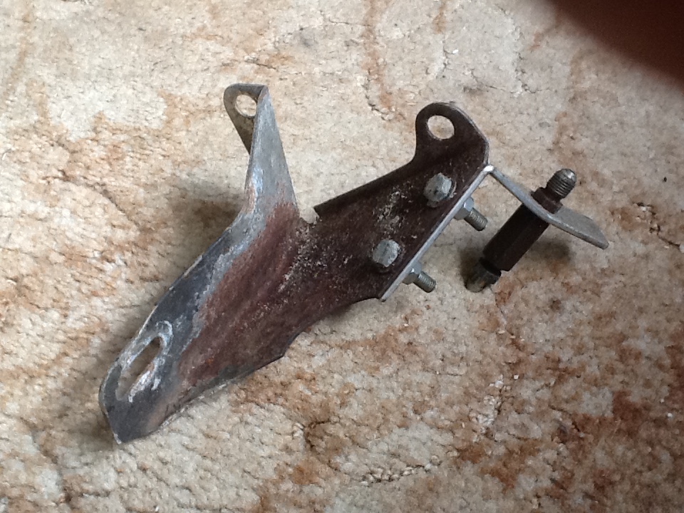

Hi,
I did this on my car
- image.jpeg (313.83 KiB) Viewed 1610 times
Re: Moving clutch bleeding point into engine bay.
Its a good idea - but if you bleed it solid off the car why bother?
You need the bleed screw ABOVE the fluid inlet to get rid of the last bubble that has wasted many a man hour....
