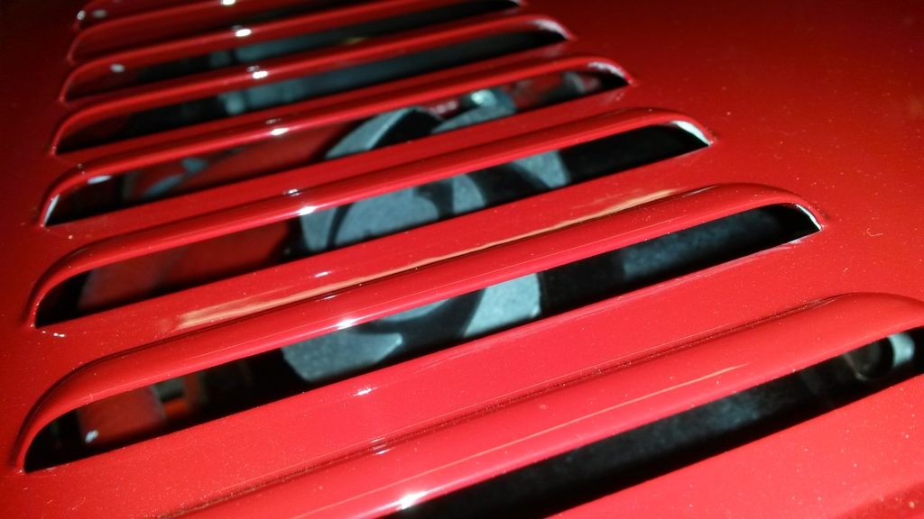

I thought mine was when I first looked, the filler cap ends up in one of the recess parts of the bonnet, it is very close, my bonnet has press lourves in that area & I can see how close the cap is, will try & get a picture for you.

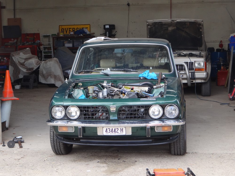

I hope this photo of my half naked SPRINT helps...
Bonnet off, radiator out, bible on the roof, tools everywhere.....while I was replacing that %#@*&! Rolon tensioner.
