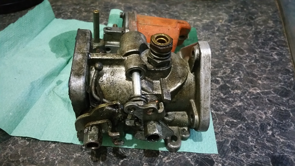

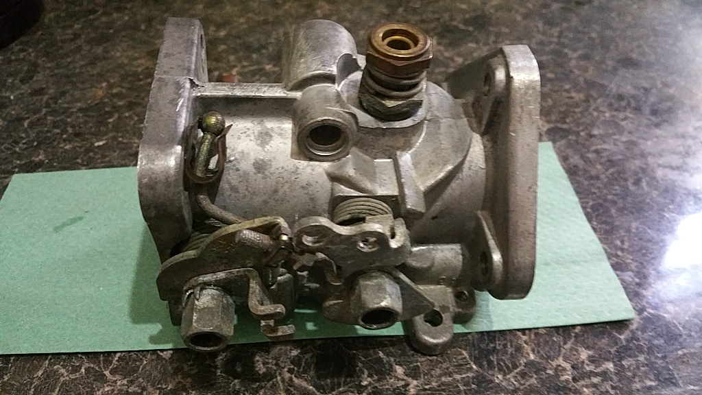

I know that there is a problem with the front carb, so naturally I take out the rear one for a bit of clean and refurb.
Ultrasonic cleaned with water and fairy washing up liquid.

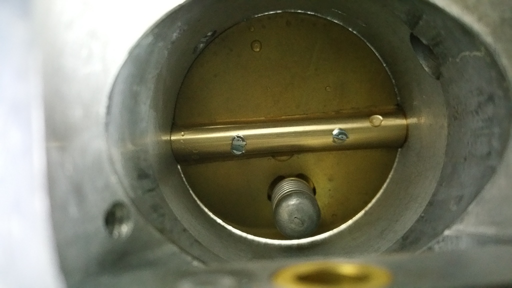

Done some more work on the rear carb this morning,
Changed the throttle spindle, throttle disc, and a couple of springs, however I still believe
the original parts seem to be of better quality then the new ones, (not saying anything
against Burlens, I'm just glad they are there to supply replacement parts).
The throttle disc seemed suspect, but I tested with water (don't know what the correct test is)
and it seems to hold it, and movement is smooth and not in any way notchy, so seems ok.
ps, I know the pic is bad, but its the only one I took.
Put the new jet in as well, but it still seems to sit low, but I have not adjusted anything and will put in the car first
to see the outcome.
Hoping to do one carb at a time, as opposed to a full out and out setup.
to see the outcome.

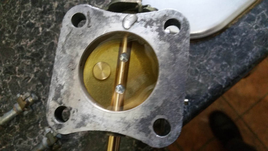

Decided on taking out the front carb this morning, checked it for mistakes from my earlier years, but none found.
Was hoping for a mistake somewhere.
Cleaned up and nearly reassembled, with new bits, however as per the rear carb the throttle disc holds water but
when I put it up to the light, it passes through, is this normal ?
I never go to this level and have never needed to. If your spindle bushes are tight enough you should have so little
air getting through that you can easilly adjust the idle to be in the range 600-1000 rpm. On a manual car 850 or so is about right for keeping the car from dropping too much when you load the alternator. On an auto you want it a tad lower
for a gentle drive takeup.
I would have used plain discs without poppet valves myself but its your car....
A smooth idle is important but its up higher that the SU does its work and here you need the right needle and spring.
But of course its all pointless (sic) if your ignition isnt top drawer.

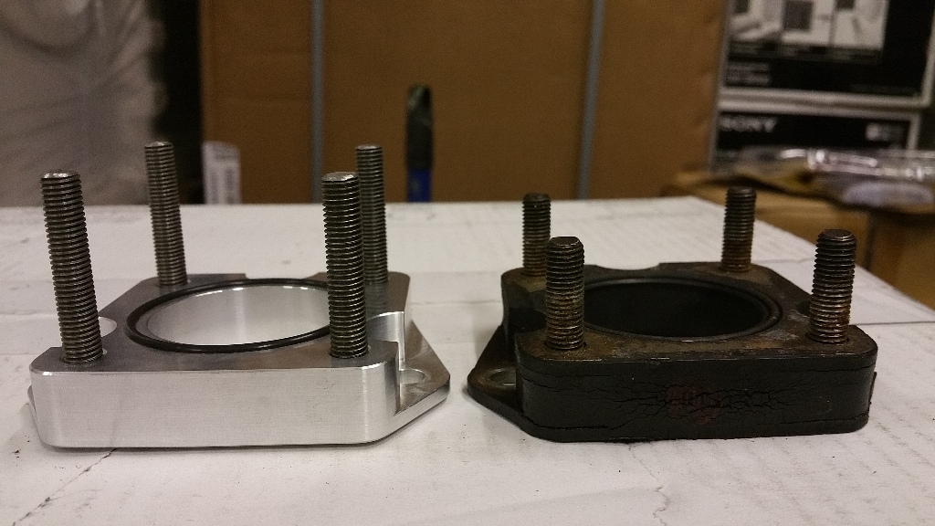

Will put on the club carb mounts on tomorrow morning.
But should I put a smear of any particular grease over the o rings, or just go with clean dry surfaces ?

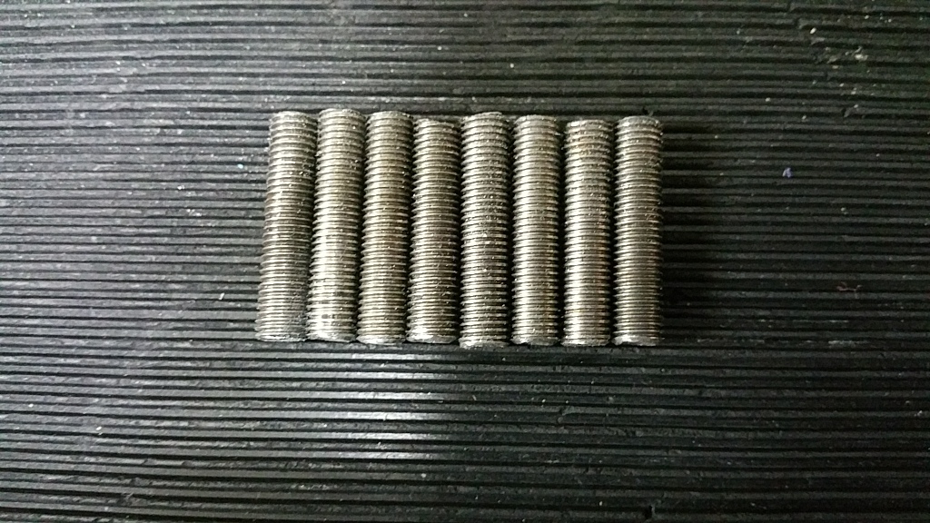

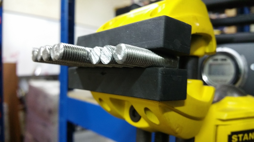

Started on the carb mounts this morning, cleaned up the inlet manifold side and thought I'd
check the studs,
they are a bit long, time for a chop,
all done, just need a bit of a rub and a couple of nuts wound through to make sure the
threads are right.
check the studs,
threads are right.
