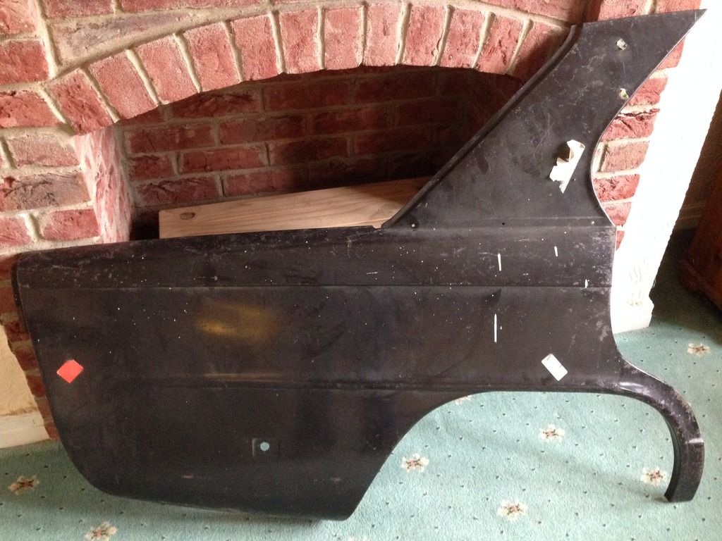

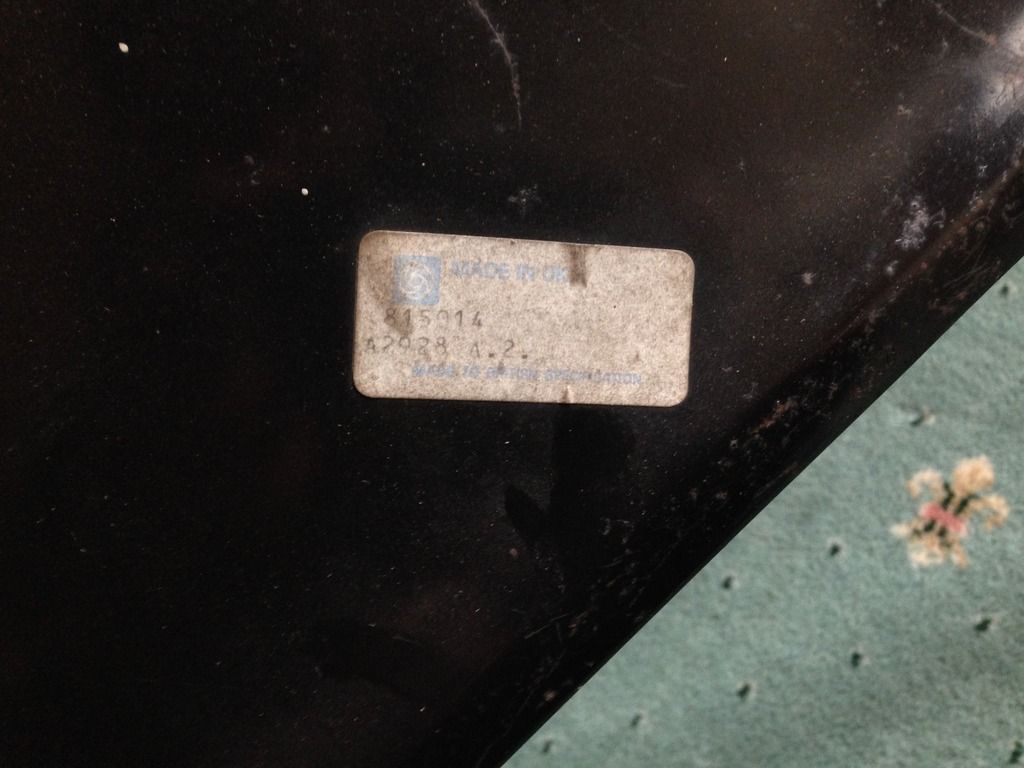

I have an NOS one Alun.
It is not for sale, but I would be willing for it to be used as a pattern to produce repair panels as long as it wasn't damaged in any way.

Thanks for the offer Tom, but in order to make the mould as perfect as possible, the panel gets bare metalled and painted, as any imperfection left gets transferred to every panel made, so whilst your's has less surface rust, a similar effort would still be required to prepare it.
Panels are not going to be immediately available, but I have secured a window in the fabricator's schedule; he's a one man operation!
