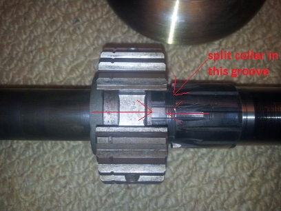

I am currently rebuilding a gearbox for my Dolomite 1850HL and I have come across a problem.
Whilst checking tolerances and making sure everything fits where it should before I actually put
it back together. I've notice a gap! it doesn't look like it should be there and it's quite sizeable.
(see image)
In the Haynes manual there is mention of a spacer which might fill this gap. But that's a
three-rail box and I'm pretty sure I didn't have a spacer there when I took it apart.
(forgot to mention its a single-rail OD box)
The Autobooks manual doesn't mention any spacers being there, and that's a single rail.
Should there be a gap? or am I missing something else??

Forgot to mention it's between the first/second synchro hub and the second gear washer.
Re: Gearbox Gap?
Does the hub push up to fill this gap? If so I would say the issue maybe the other side. Maybe the gear needs moving in?
Re: Gearbox Gap?
The gap is filled with split collets IIRC....They often fall out in the box as the mainshaft is tilted upwards for removal and the first gear
slides backwards letting the collets drop out. Blob of grease sticks them back for reassembly
The inner part of the synchro hub stays still on the shaft. Only the outer bit moves...

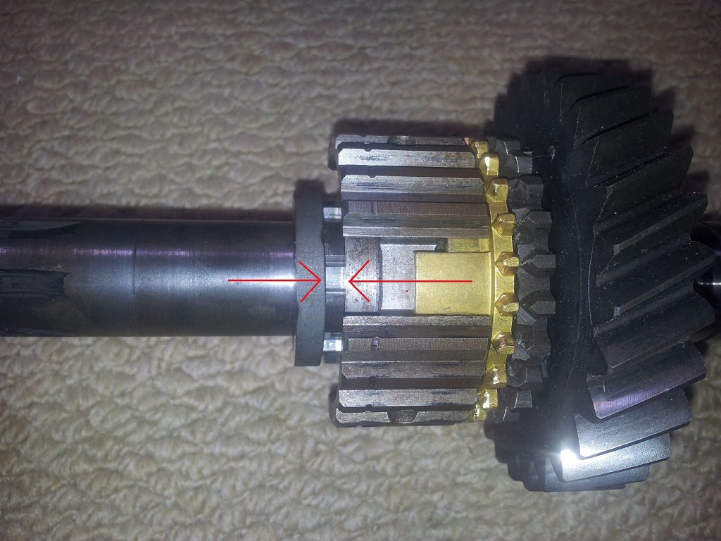

I can move the synchro hub so it's up against the second gear washer. But the first gear can't move any further up because of a split collar that sits in a groove on the mainshaft. So I end up with the same gap put on the other side. So if I were to assemble the mainshaft like this the first / second gear synchro hub would be able to slide up and down the mainshaft by about 3mm, which doesn't seem right to me.
I've put together another amazing paint diagram to demonstrate this.

Re: Gearbox Gap?
The third / fourth synchro hub does not incorporate the reverse, I expect the first / second sychro hub has to include clearance to ensure forward and reverse gears are not selected at the same time. Additionally have you tried the first gear in position as the synchro cone incorporated into the gear and the synchro ring will also reduce the available movement range.but the third / fourth synchro hub doesn't seem to have that level of play?
edit.
I have a unused reconditioned single rail overdrive 1850 gearbox in my spares, checking the free movement of the synchro hubs I measure approx 1.5 mm for the third / fourth synchro hub, and 2.5mm first / second sychro hub.
