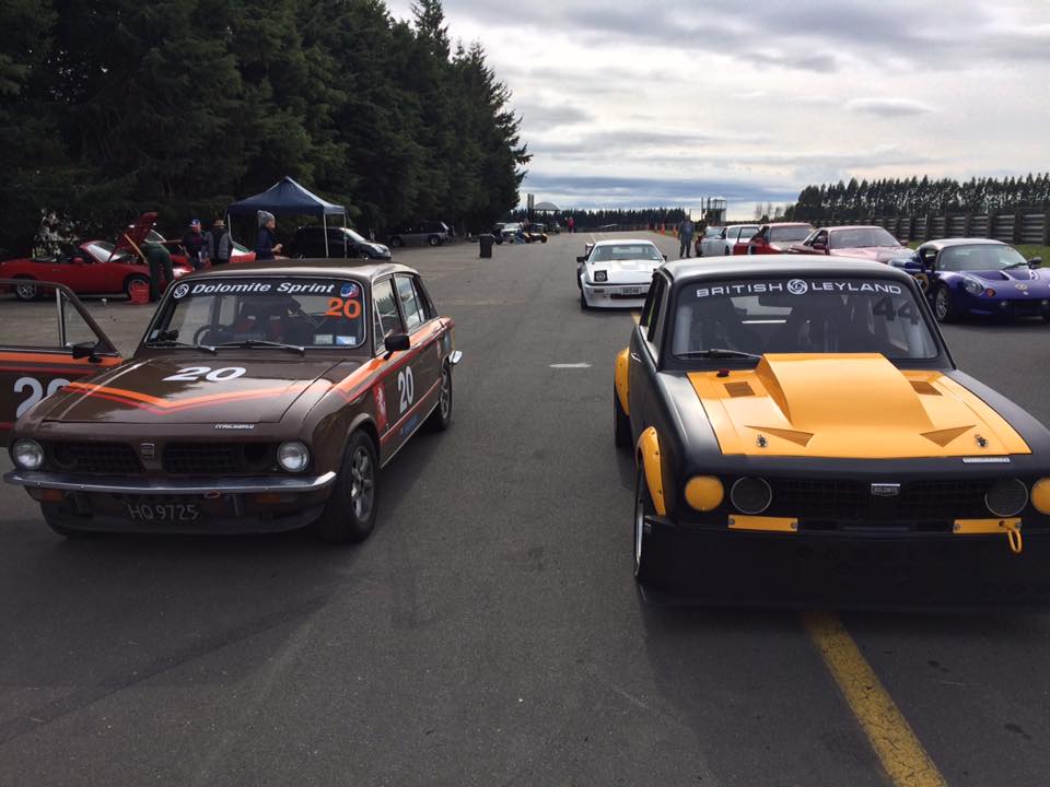

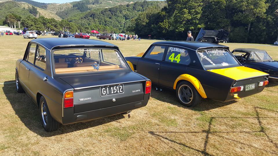

At least the day's racing at Taupo last Saturday went with a hitch. Interesting to race with the only other Dolomite racing at present in NZ, not a Sprint but a Leyland P76 powered 4.4L V8. Nigel has had the car about 10 years now and it is beautifully presented (he also has a very nice 2 door Toledo and TR7 3.5V8 in the same matt black finish). Not that much faster than me which made for a lot of fun when they let me off 5 seconds before him. Took a few laps before he could pass even after he'd caught me up. There was also a heavily modified TR7 (5.0L TVR motor) which did leave me for dead in a straight line!
Triumphs at taupo.jpg (72.26 KiB) Viewed 582 times
Toledo as well.jpg (122.64 KiB) Viewed 582 times
