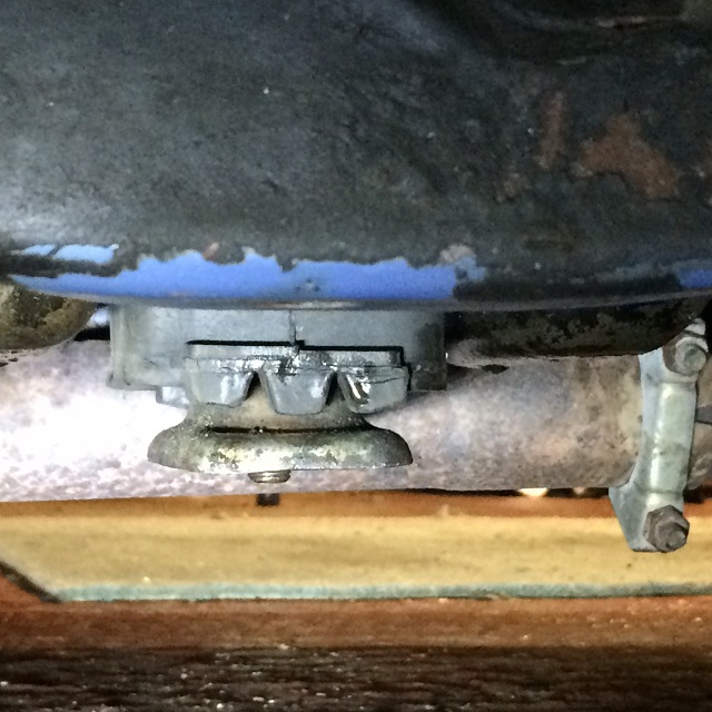

Hi
Can anyone quickly confirm the gearbox mount is not fitted correctly. I think the gearbox should be jacked up higher so the plate is snug to the mount.

Can't really tell from the photo but I think you have the mount upside down or mounted to the wrong side of the crossmember, here's mine from my resto thread:
Click the link & scroll down, you will see pictures!
viewtopic.php?f=19&t=25122&start=240

Thanks. You're right. Fitted to the wrong side of the cross member.
