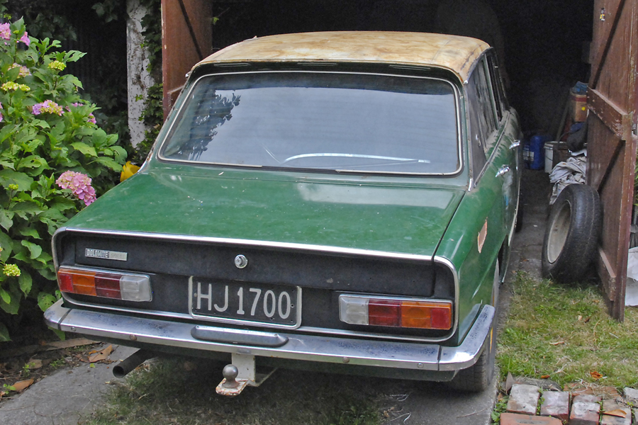

Sitting in the gloom too has helped to preserve items like the seats and other trim although the chrome has become pitted and some rust has come through the paintwork.
Here in New Zealand we do not have ready access to the vast range of spares available to you who live in the United Kingdom. We can import parts but often the freight cost makes it uneconomic to do so. We have to make do or cannibalise parts from other cars. It is important therefore when starting a restoration to be able to use as much of the original car as possible. It should be possible to reuse most of HJ 1700 as can be seen in the photos.
Sadly the registration on this car has been allowed to lapse. In this country too cars have to be licenced on a continuous basis but unlike your SORN process we can elect to place the registration “on hold” whilst it is undergoing restoration. If that does not happen then the car will have to be re-registered some time later as a “new” or in this case follow a similar process as a “second-hand import” and undergo a very rigorous inspection before a new Vehicle Identification Number (VIN) can be issued and new registration plates can be attached to the car. There is a significant cost to do so. I am hopeful that we can find a way to retain its original registration plates which the car has carried since it was first registered in this country sometime late in 1975.

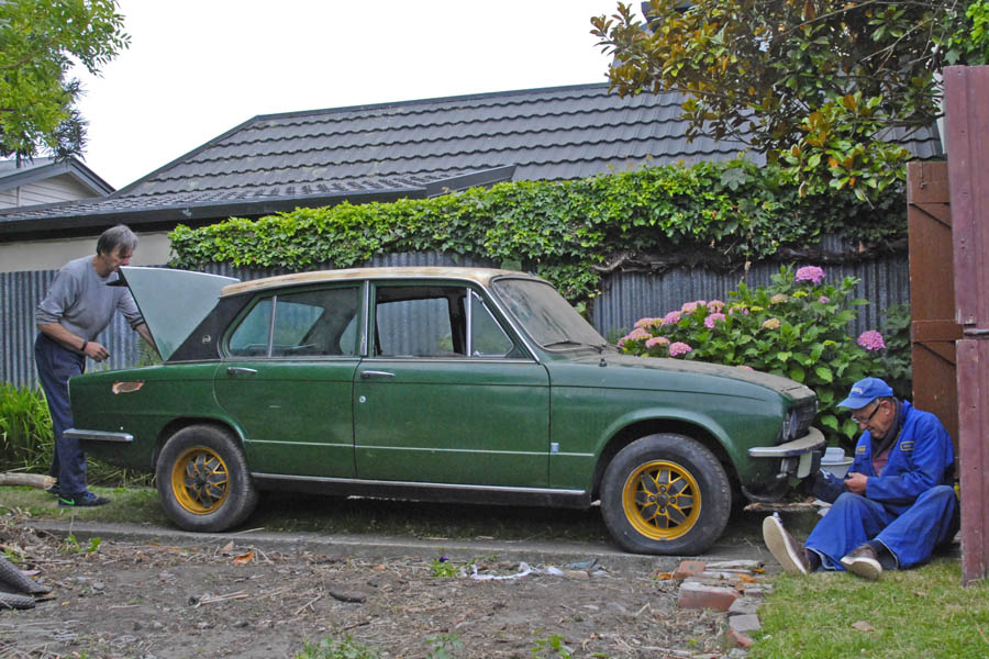

An a-frame attachment was bolted to the front bumper, the car moved onto the lawn beside the shed and then turned round so that the large Toyota 4x4 could tow it back to my workshop.
While Kevin loaded some miscellaneous spares into the boot I attached the brackets to the front bumper prior to fitting a couple of inflated 1850 wheels to the front for the journey home.

The original vinyl roof has been removed from the car at this point so that we could inspect for rust. Then having turned the car round it was coupled to the tow vehicle and left the property where it has been resident for well over 20 years.

As we drove away a passer-by commented that Dolomite Sprints were pretty rare and wondered whether the car was making its last journey to the scrap yard.
It arrived here and now sits alongside its sibling, HU 5000 which carries the chassis identification VA 10113 DLO. HJ 1700 carries the chassis identification VA 10180 DL.
20151228-5667Ptw Sprints HU 5000 & HJ1700.jpg (227.18 KiB) Viewed 4691 times
Close enough in this country to almost be considered twins. HJ 1700 started life painted white, paint code 19 with Black C 11 Trim. Whilst elements of the trim will need replacing such as the carpets I also have a Pimento 1850 which is beyond restoration which shares the same trim colour so it may be possible to make do with what materials I can salvage from both cars.

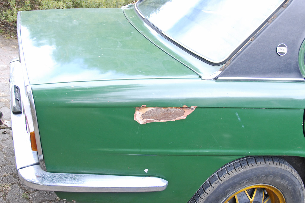

There is a rather poor repair to the right rear quarter panel which has been dented and rather than pushing out the dent it has been filled and painted. I expect it can be knocked back into shape relatively easily.

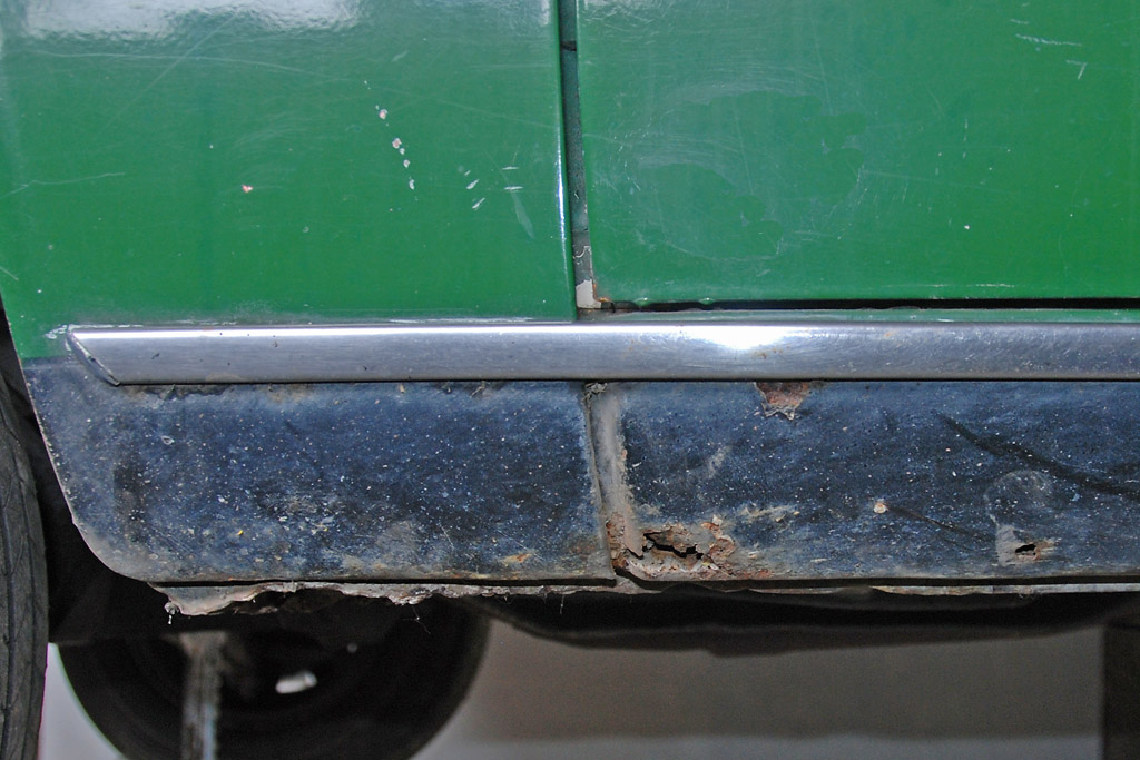

The front left sill has a couple of holes in it, as can be seen in this photo.
20160104-5692Pxt HJ 1700 LH front sill corrosion.jpg (211.6 KiB) Viewed 4440 times
The jacking point has also been damaged.

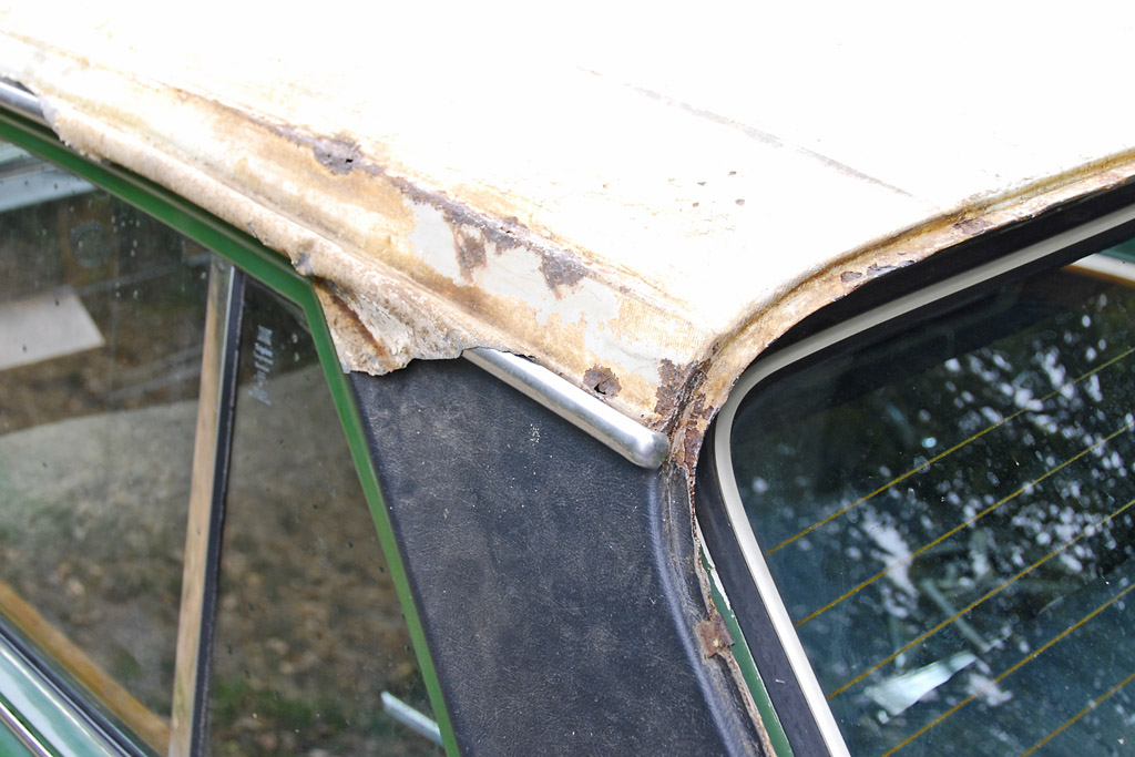

There is rust in the left hand side of the roof, as I show in this photo.

I am not overly concerned for I do not see it as a major structural problem. The only problem will be that in order to weld in that area the headlining and insulation will have to come out when I carry out the repair. In my experience it will be a long and laborious process to refit the existing headlining back in perfectly. It may be easier to purchase a new headlining and fit that. If that looks like being the case then I will throw away the existing pull down grab handles and fit the later style.
I would prefer not to fit another vinyl covering to the roof. I can see no merit at all in doing so and am in fact considering removing the vinyl roof covering from my own car. It serves no useful purpose at all and simply makes the car hotter in the summer.
