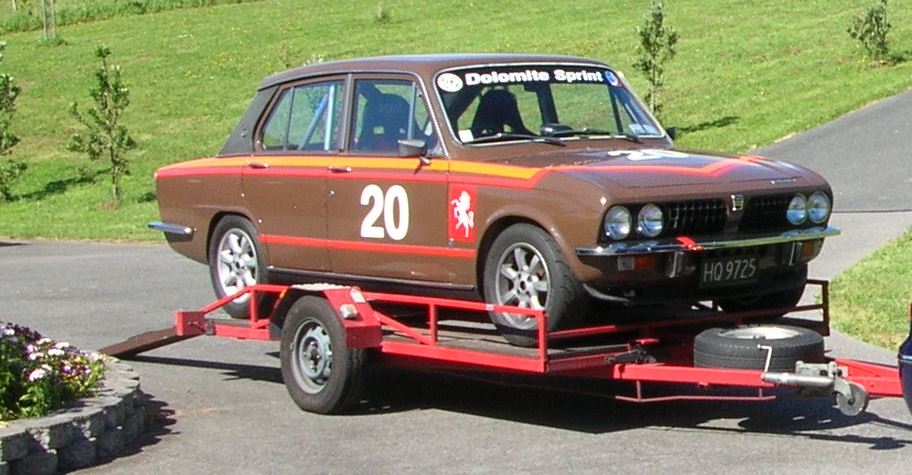

Don't know anything about UK legislation, but just a comment that a trailer weighing 650kg is something of an overkill. Mine (photo below) weighs in at 350kg. Done many thousands of km like this. Tips to load, braked but no suspension so need to tie the wheels not body and with van tyres to cope with the weight. Can you not find something lighter to hire or borrow? That would appear to solve your issue completely.
In NZ tow bars are rated according to the car they are fitted to, so all you have to do is stick within that limits for unbraked or braked. My XF is 1800kg braked so at 1350 for car and trailer, I can carry quite a few spares as well.
If you can't find a lighter trailer, sounds as though you'll need to find the nearest public weighbridge.....
Geoff
