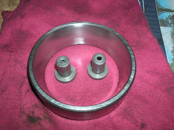

The halfshafts do mate up with parts of the centre diff and can put undue pressure on that if the end float isn't both correct and equal. Can't show you the parts on a standard diff but my original LSD was damaged when it was installed by 'a professional' who shimmed the axles unevenly. You can see from the following photo how the parts of the centre diff where the end of the halfshaft contacted were worn (on one side where there were no shims!). This was only part of the damage as there are taper bearings on each side of the diff head which can wear if undue force is applied if the end float is large. One of the reasons I try to do as much of the work on my racecar as I possibly can and only let a couple of people I have complete trust in near it (or any other car I own come to that).
diff centre.JPG (52.33 KiB) Viewed 1187 times
Geoff
