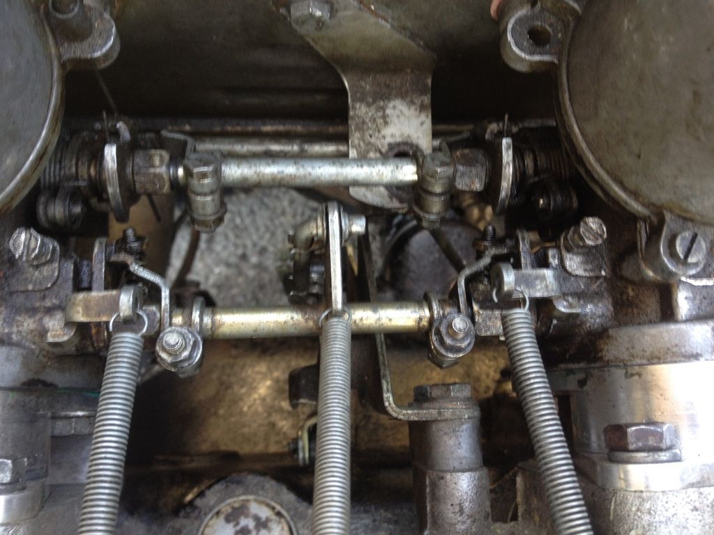

Well thats great! I will definitely give them a go then, and see if I can get hold of some throttle spindles. As for the throttle return springs, they're this type:
Apologies its not a better picture, its an old one. Is there a better way to have the springs/better springs to attach I take it then?
I would grab a pair of carbs off Alun, ideally the later type with concentric springs. Then rebuild those as required, and swap over with yours. Simple solution!
