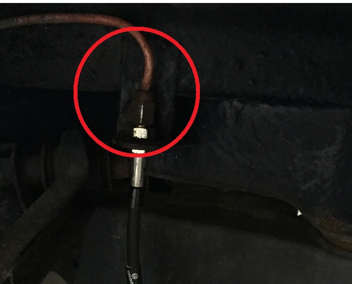

Ready to break. It is twisted very much and will snap off soon.

Jeroen is right. I had a steel pipe fail once at this very spot through corrosion....on the MoT brake rollers!
Re: PUS - My First Sprint (and my first classic car)
You could try putting thick grease on the part of the pipe where the fitting goes. Then slide the fitting over it. Then put more around the top when fitting is done up. If you do your best to keep moisture out you won't get corrosion there.

Ive never ever had a problem with copper lines, and ive fitted plenty.

Next up was to replace the NSF brake pipe as it got a little twisted when replacing the hoses previously. Better to be safe than sorry and all that.
