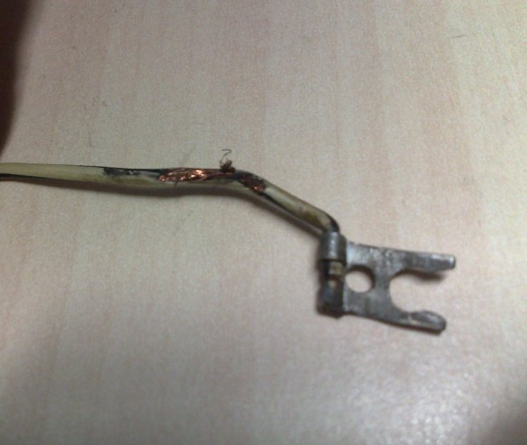

I've had a strange misfire on the 1850 recently. O.K. I still run points , but I found it was due to the wire that runs from the points, through a grommet in the distributor base and then up to the coil.
It has been rubbing on something and was difficult to spot as it was on the underside. Its an easy job to pull out the grommet complete with the wire, and re-solder the connection on a good bit of wire.
flexi-lead to points.jpg (64.46 KiB) Viewed 1960 times
Problem gone away !

Well done Tony. I've seen that before. Dad owned an Allegro and he had that happen several times during his ownership of the car.

I think it's rubbing on the base of the rotor arm/bit that the rotor arm screws to. I had to move the wire out of the way on mine.
