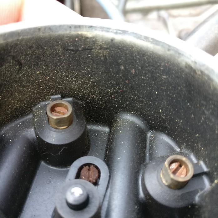

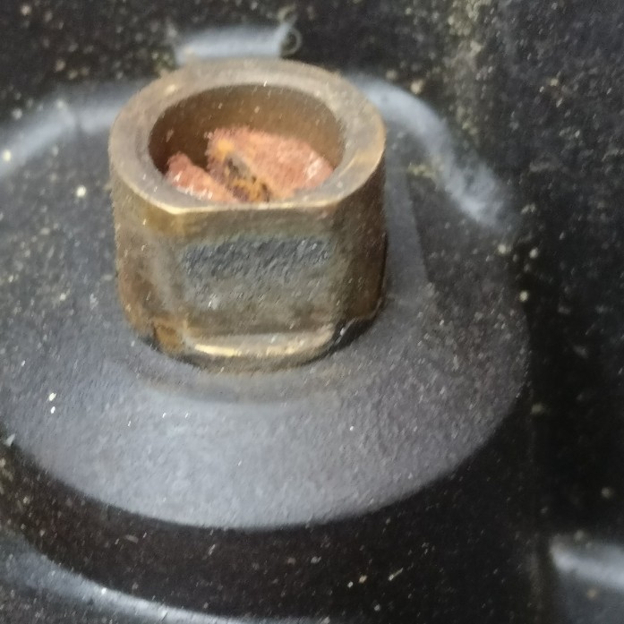

My drive home was even worse than the journey in, it struggled to keep up a decent motorway speed.
I've just got back and had a look at the dizzy and rotor arm. It's been a while since I had a car with a rotor arm and dizzy cap but this looks pretty poor to me. Any thoughts

That cap looks way pass it's best, never seen rusty screws inside a dizzy cap beforeAleco wrote:My drive home was even worse than the journey in, it struggled to keep up a decent motorway speed.

I thought it was ropey, pics don't really show it but it looks like it's been sparking across two terminals and then hitting another.
I've got a set on order from Rimmers ready to be joined with my new leads from the club.
After a number of false dawns I don't want to get my hopes up!
