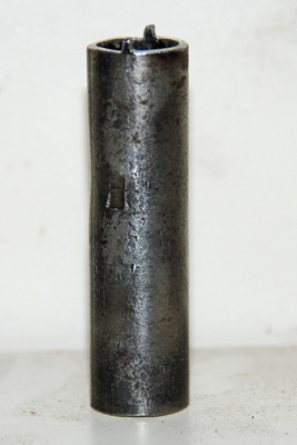

If you loosen the nut below the knob the inner threaded collar can be teased out easily with a small flat screwdriver. When you refit you want
maximum space inside the knob for wire and connectors so put the collar on the threaded section at the very top and do it up untils its flush with the stick. Then tighten the lower nut against the knob to secure.
- Posts: 389
Re: Removing overdrive gearknob
Jonners is absolutely spot on with his advice here. I found a piece of tube in my scrap tin and filed it so that it fits the two slots in the inner threaded collar. I have used old box spanners in the past to create similar tools. I slide the wires for the switch up inside the tube and then turn the tube to remove and reinstall the collar.
It is absolutely essential that you take the collar down until it is just flush with the top of the gearstick – as Jonners has recommended. Then I reach down and for those of you who remember how to milk a cow, use your hand to “stroke” the outside of the gaiter and gearstick and pick up the wire where it exits the gear stick and gently pull it/work it down with the gear knob cover and switch attached until the cover is just about in place. Then all you have to do is push the cover into place without bunching up the wires beneath it.
