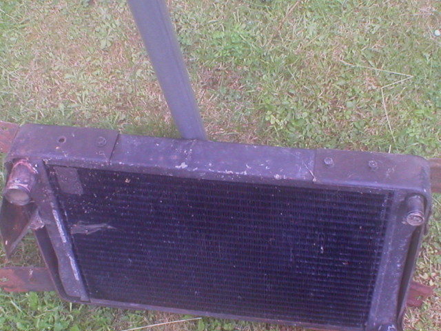

Hope you are well. I've been looking into getting a new radiator, however none of them come with the plates to attach the thing to the bodywork? Mine look like they have been welded on. Whats the best way to go about getting hold of these?

Hi Kyle, the bracket attachments should look like the photo here. There are 4 small bolts on top and 4 underneath which are invariably rusty. I think something like a 3/8 in A.F. socket will get them out with lots of Plus-Gas. The brackets then slide off.I f they have been welded on ( probably brazed ) then the reconditioning place will have to attend to that.

ah, I understand how they are now. Thanks again Tony! :) :)
