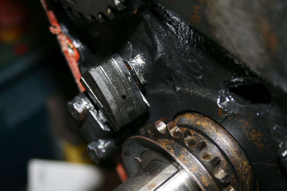

All this talk of chain tensioners leaves with a dilemma. My 1850 has only driven about 60,000 from new. In my photo you can see the tensioner, which I am sure is the original one fitted by Triumph. It has two distinct grooves on it.
The question is, should I leave it alone, or should I replace it, and if so, from whom should I buy the replacement? Over to you.

Completely normal wear pattern and fit for at least another 20k miles.
If it aint broke dont fix it...
but it depends what you want to do/
TR7 and stags use the same bits so supply is not an issue. Robsport and co have decent ones, but I'd reset and reuse that one myself being
a cheapskate.
1850's give plenty of warning as the tensioner reaches the limit and the chain starts to rattle.
a cheapskate.

Thanks Jonners, I'll leave it alone then. What do you mean by "reset it"? I'm unfamiliar with most things Triumph-related.

You can set the tensioner to its fully in position, tighten the chain by adjusting the curved guide and then release the tensioner so it springs out.
Some work on a push in to release mechanism and some have an allen key access hole to twist and release the ratchet from its end peg.
You will see how it works when its all off.

Thanks. I didn't know that.You can set the tensioner to its fully in position, tighten the chain by adjusting the curved guide and then release the tensioner so it springs out.
