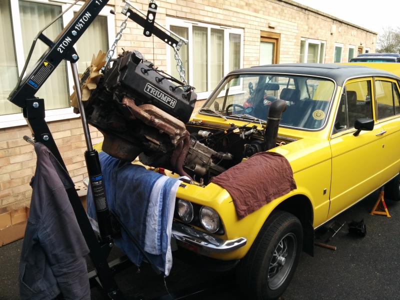

You need to get the engine at a crazy angle with a load leveller, and have the car level but it comes out with a bit of a shove just fine, make sure you protect the front valence with thick carpet or something similar.
- IMG_20160403_145704_s.jpg (253.42 KiB) Viewed 1380 times

Everything above describes how to remove it; this is easier than refitting because it literally drags the tail of the gearbox out. If refitting without dropping the rear of the subframe you need a willing assistant who has basic knowledge of what needs to go where to guide the tail of the gearbox back in, or else you'll find yourself doing it a half inch at a time flitting from the crane to the inside of the car and back!
- Posts: 7249
Re: Engine & gearbox removal
Putting it back in, you just need a trolley jack, in line with the crane to support the back of the gearbox as it goes in. This will take some of the weight off the load leveller and automatically alter the angle for you.
