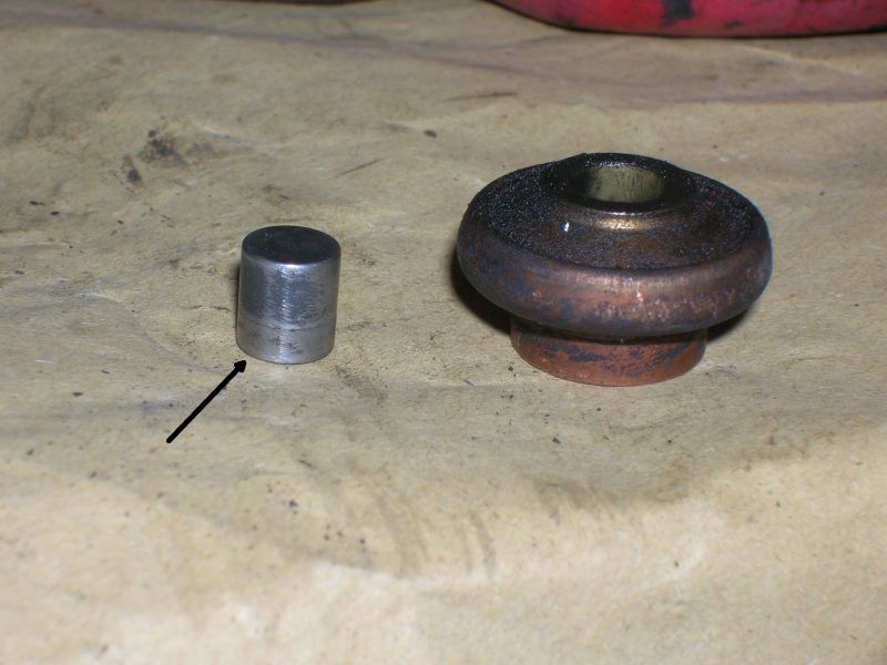

A couple of quick queries. I have been cleaning up the carbs and have had the jets out to free them up - they were stuck after their 26 year lay up. I have replaced the waxstat with two penny coins as recommended all over the place. With the jet nicely assembled and free to move I find that when wound right up to the top, the jet is still nearly 1/4 inch below the level of the bridge. Is that OK? My experience on earlier SUs is that the jet could be brought up level with the bridge, but maybe its different with these later instruments.

Did you replace the little metal "bit" that fits between the waxstat the the jet? (maybe 5mm long, and similar diameter. Please forgive me if that is way out, last did this donkeys years ago)

Thanks Clive, you have it spot on. The bit I left out is the little silver cylinder shown in my photo. Having put that in, the jet now winds up to the bridge. Another problem solved.
