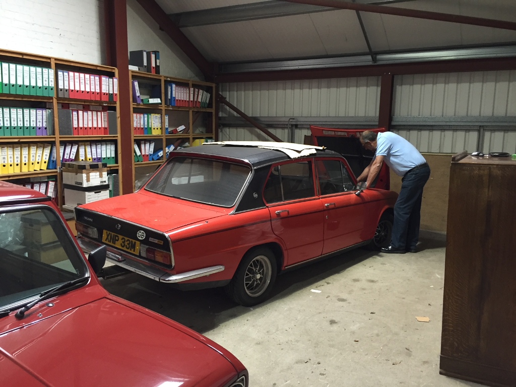

A bit of back ground info on how i ended up here. A few years ago, a family friend told me about a Sprint they had sat in storage that would not start, several people had attempted to get it going. He said to me 'If you can get it going, You can borrow it'. So over i went with some tools and some fuel, An hour later shes running a dream. So i borrowed the car to do a classic car run & absolutely loved it. Thats where my love for the dolomite began! Unfortunately i had to give the Spring back afterwards.

Nice to see that Sprint is still with us. I used to see it regularly on my way to work and out and about in Stafford in the late 1990s, it lived on Woodlands Road if I remember rightly.

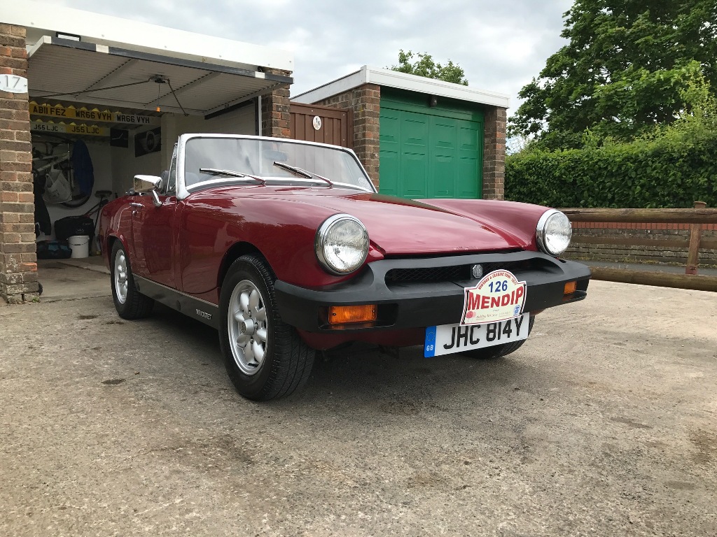

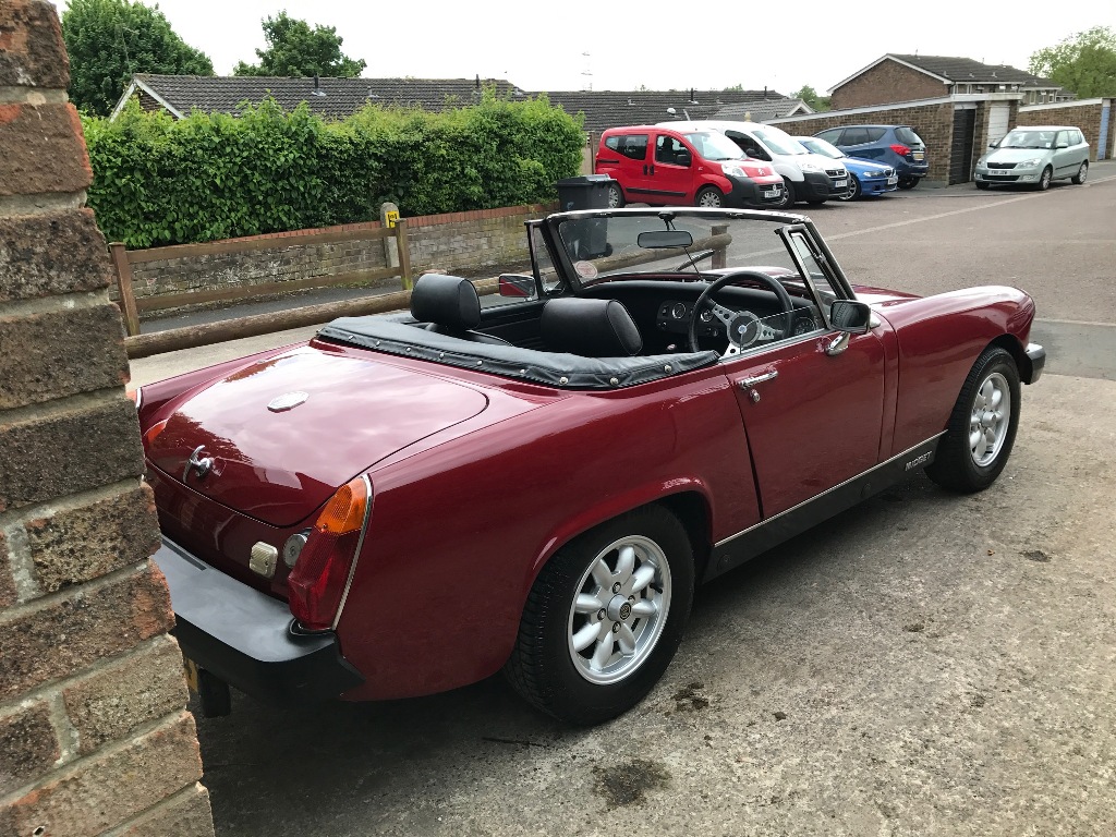

Three gorgeous cars. I especially like the Sprint as it's the same colour as mine. Is it an optical illusion, or does the panel gap at the back of the driver's door on the MG widen significantly from top to bottom?
Re: NAB 755T Dolly 1500HL Project
Im sure the Sprint is still alive somewhere, It was sold at auction about 6 months or so ago so i have no idea where it may be now.
the sprint was very nice, However underneath it could do with some work.
In regards to the MG door i think its an optical illusion, As its not that far out in person.
