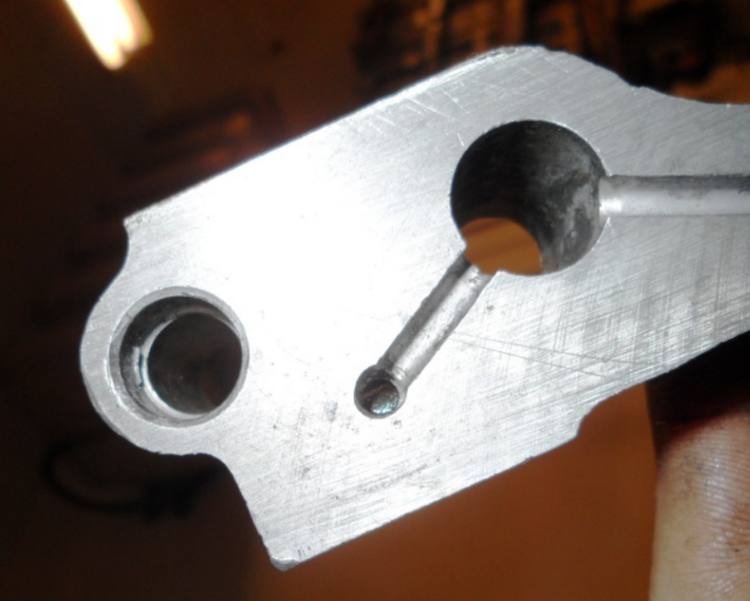

And when you are at it you can check the oil supply to it also. Almost all sprints I've seen had the plug in the cam bearing cap too deep pressed in almost blocking the oil supply hole.
2018-02-07 12.13.39.png (589.12 KiB) Viewed 714 times
