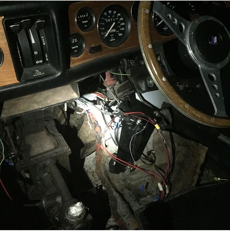

Been busy with housing issues and family commitments so haven’t really been working on the car, think maybe worked 30/40 hours in the past 10 months. Got the transmission cover removed and engine prepped for removal, just need a full day to get it pulled out.
Done a lot of planning and designing up engine mounts as I couldn’t modify the passenger side mount as it incorporates the oil filter and cooler, looking into filter relocation kit and to build a mound off the fromt of the engine to the existing cross member.
Having issues with cheap alternative axles to use but best bet at the moment is Ford Atlas or Capri rear end but don’t have the space to store one currently. Main issue I’m coming accross is space management as my garage is quite small and it’s very full of stuff like kayaks and pushbikes. One that’s sorted, more progress should come
Current plans are for a Group 2 style build but with some modern twists such as Radiomobile 1090/80 radio for period correct look but utilising my currently sorn BMWs heator matrix and re use the triumph one for a rear windscreen de mister as the stock one just drained my battery without doing anything. So if anyone wants rear windscreen with de mister stuck to it, PM me
That’s all for now, pictures attached of transmission cover removal and battery box to house the massive type 19 battery the jag used
