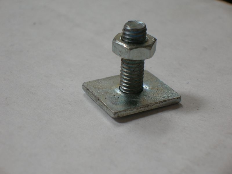

Here we go. I've found the MGB trim fixings and here's a photo of one. The plate measures 5/8 x 1/2 inch, the stud is 5/8 inch long including the thickness of the plate, and the screw is 3/16 inch diameter. It is called a Stud Plate with the part number AHH6360, and the nut and washer are listed separately. The nut is GHF206, and the spring washer is WL700101.

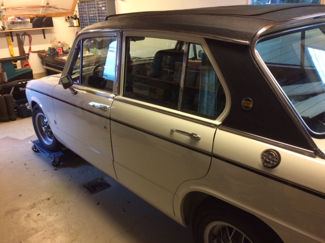

Another option is to fill the back of the stainless steel trim flush with body filler so that it can be stuck on using the double sided tape that is available for fitting car trim.
Re: Attaching lower door trims
That's what I did with the door trim. I filled up the strips and stuck it with tape.
I just hope it will hold.
