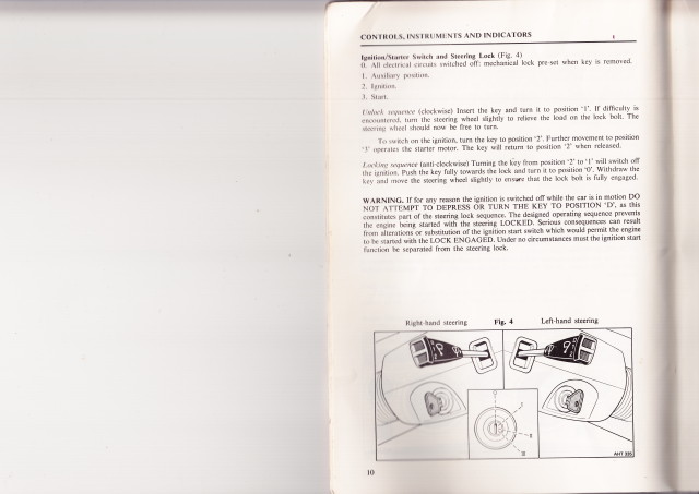

Re: Steering lock question.....
This does seem to be correct according to my 1850 Owners handbook.sprint95m wrote: ↑Tue Feb 13, 2018 10:13 am This question is regarding a 1979 Sprint.
The steering lock on this car is unlike the other Dolomites (and 2000s) I have owned.
When switching off you can turn the key all the way back to position 0, whereas I am
familiar with the key only going back to position 1, then having to be pressed and turned in order to reach position 0.
thanks,
- 1850 steerlock.jpg (54.4 KiB) Viewed 2009 times
