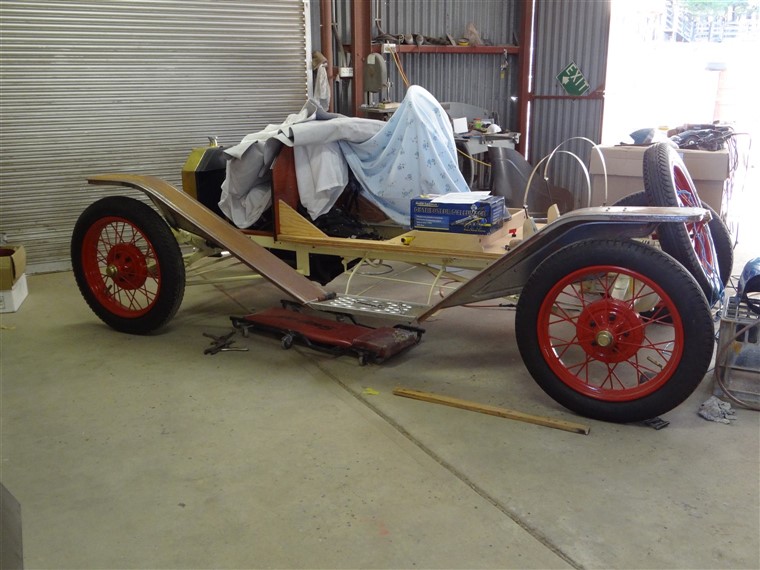

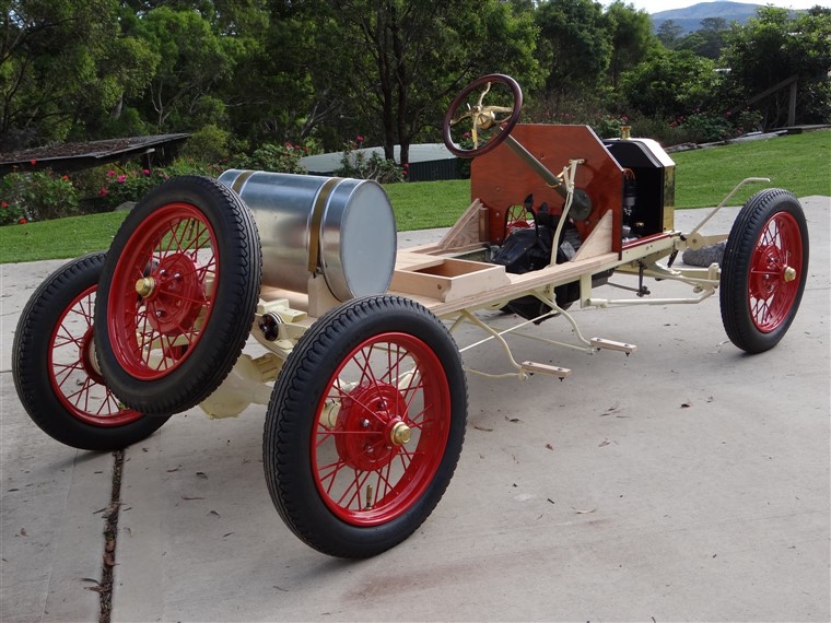

It was my vintage car specialist Panel & Paint guy, David, telling me he's ready to fit up the bodywork on my 1915 T Ford Speedster.
Rather than it being a restoration, I've been building this car from bits and pieces, on and off over the past 7 years and this is the last stage of the build.
I figured you might be interested in seeing the project as it is now and as it should look when finished.

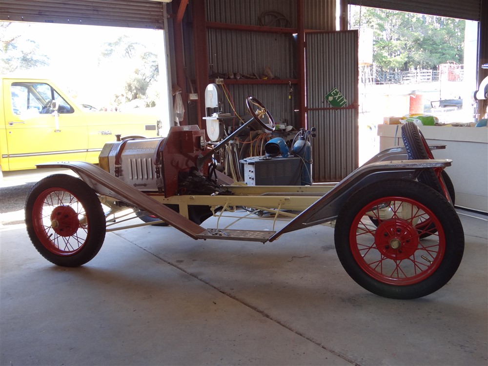

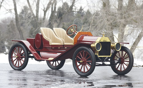

Apart from the colour and the wheels, the first pic is close to how this should look when finished. Mine will be Cream where its Maroon and the seat leather will be red. The last 2 images are the car now, waiting to go to Daves workshop which I might add is about 200kms away.

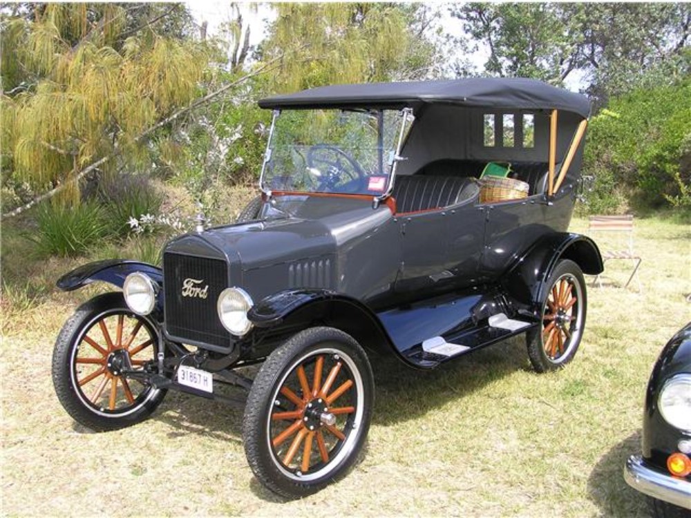

About 15 years ago I restored a 1921 Model T that has been in our family since 1964. It was during that restoration that I fell for and realised I could build, a model T Speedster.
So this project is the end product of a dream, I suppose. I've attached a photo of our other T. A long-ish but humorous story goes with the car. Maybe, another time, I'll post it here.

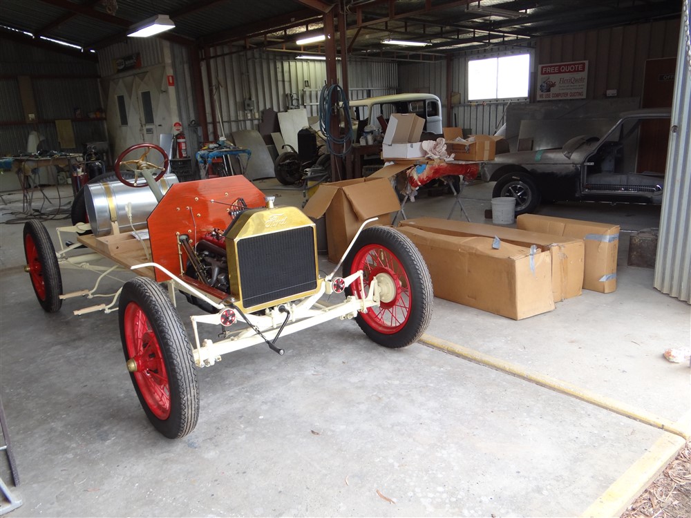

Today we loaded up and took Evangeline inland to the panel shop.
This is no ordinary panel & paint business. Two brothers have been working side by side for decades and lots of their work has gone on to win concourse trophys. Their business is not in town but rather out in the country in a small-ish, well equipped shed behind a farmhouse........but not too far from Canberra.
Evangeline's in good company with an XK120 Jag Coupe, an MGB-GT and a '34 Dodge.
The mud-guards/fenders/wings, hood/bonnet, running boards seats etc; are in those cartons beside the girl.

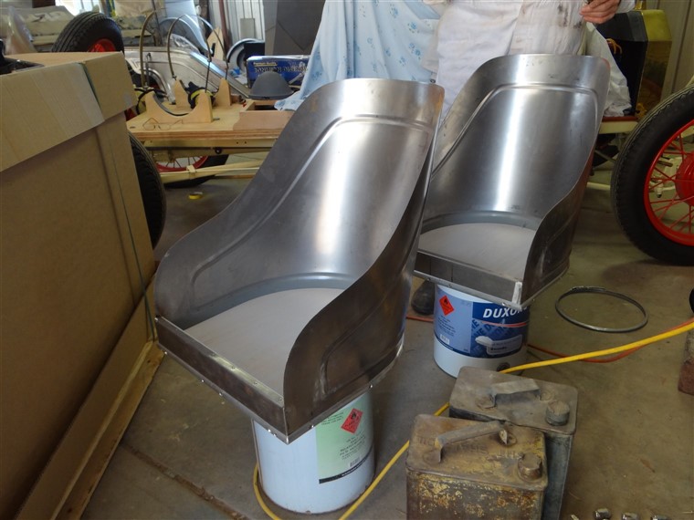

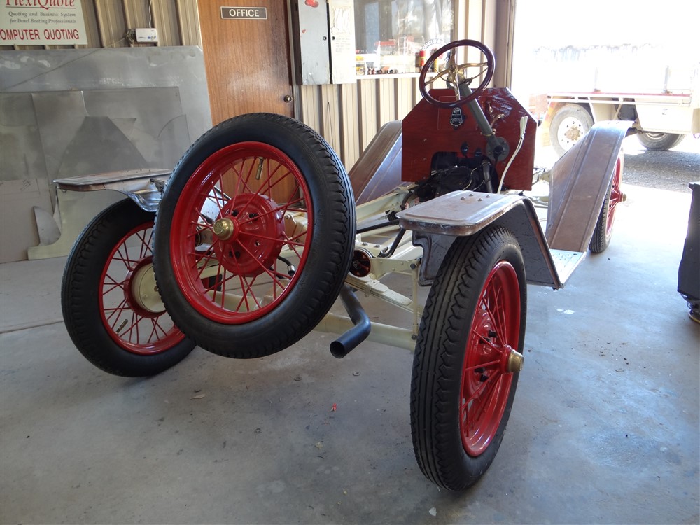

Speedster update

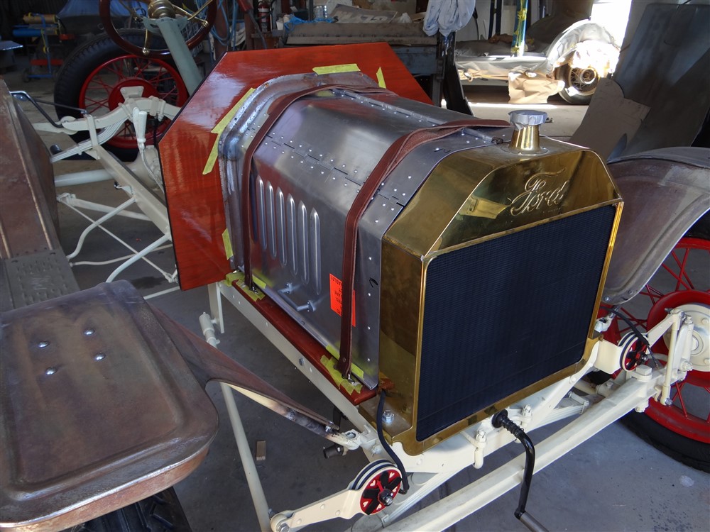

I had to attend a family funeral in Canberra the other day, so I took the opportunity to call in and see the progress on the Speedster.

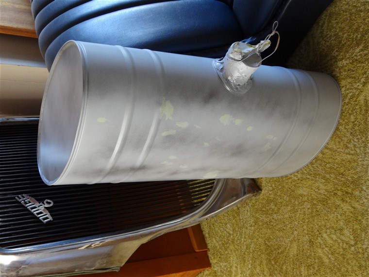

I'm pleased to say that it has advanced quite a lot in the 4 weeks since I dropped it off. The only thing damaged in transit from the USofA was the fuel tank, which has now been repaired, had the brass filler attached and is now ready for paint. Likewise the seat buckets are also ready for paint and will be sent to the motor trimmer for some bright red leather ASAP.

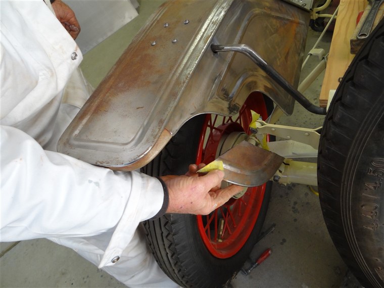

The left side front and rear fenders and running board were being massaged when I arrived. Its crucial that the flat tops of the fenders are level, in the same plane and parallel with the running board. This was causing David some grief at that time. You can see from the photo that the rear flat top was pointing towards Mars, but a few hours later and after some massaging, is now level. I've fitted this car with friction shock absorbers and in order to fit the rear fenders, their inner skirts needed to be trimmed around them. You can see the piece removed and the swage beaten into the thing to follow the new lines.

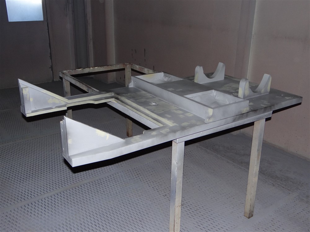

I had to deliver some more parts the other day so I took some more photos. They're pretty self explanatory except for maybe the wooden deck/floor in the spray booth.
