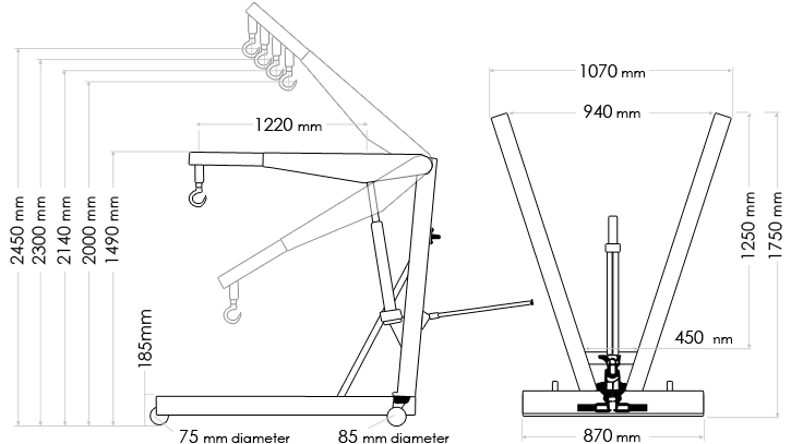

Your pic of the crane is interesting. I'm finalising plans to get my engine back in, hopefully later this month. When I removed the engine from the old shell I did manage to damage the front panel because I found the hydraulics not very forgiving. I was planning on using my dad's hoist which has a screw system instead but on looking at it we were wondering if the beam is too short. The beam cannot be adjusted and is fixed in length but decent height can be achieved. My concern is that the beam is too short and the front of the engine may hit the upright but actually looking at your pic the hydraulic part is pretty much in the way on your removal.Galileo wrote: ↑Wed Aug 01, 2018 10:15 pm You'll need a long nose engine crane, a load leveller (invaluable) and 4 x axle stands or ramps as well as faith in the extreme angle you need to get it out. jacked up high at the back is needed for clearance. Make sure you well protect the front panel against any possible damage with old carpet or similar, also best done with someone else who can keep an eye on the gearbox tail as you ease it out and give things a helpful shove. As to what to remove, Haynes says lots but I did nothing more than disconnect all pipe/electrical work,exhaust at the front pipe, speedo cable and the propshaft then remove bonnet, radiator and heater blower hose (trust me). All the ancillarys stayed put.

Any idea on the length you used on your beam to achieve the removal/refit?

This is the dimensions of the crane* I've got, which you're welcome to borrow if you can get yourself over to Huntingdon! IIRC I used the 2450mm setting on the crane but might have got away with less.SprintMWU773V wrote: ↑Thu Aug 02, 2018 10:09 am Your pic of the crane is interesting. I'm finalising plans to get my engine back in, hopefully later this month. When I removed the engine from the old shell I did manage to damage the front panel because I found the hydraulics not very forgiving. I was planning on using my dad's hoist which has a screw system instead but on looking at it we were wondering if the beam is too short. The beam cannot be adjusted and is fixed in length but decent height can be achieved. My concern is that the beam is too short and the front of the engine may hit the upright but actually looking at your pic the hydraulic part is pretty much in the way on your removal.

Interestingly I notice that the rear end of your car is not especially high, you could have lowered the front somewhat too. This gives me a little more confidence, though it's the control of hydraulics that worries me.

Not ridiculously high, the stands were on their highest possible setting sat under the rear jacking points as on the axle there was not enough clearance. The picture shows everything coming out, went back in with an overdrive box fitted. Watch out for the end of the gearbox remote catching on the lip of the tunnel if you're doing it by yourself, and be prepared to just clear the front panel by a fag papers thickness, hence saying protect it well. It's honestly not as epic as it might read!
