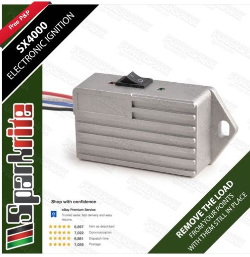

Final, final update - after a couple of days with the points fitted the car starts and drives well. As I do miss not having to check the points I decided to fit this amplifier which is supposed to save on the points burning and to take up the slack from wear and tear. The thing is, without the amplifier, the new Lucas coil was hardly warm to the touch after driving. After fitting the amplifier and driving the same distance, the coil is noticeably warmer ( but not hot). Having said that, the old Lumenition coil (+ magnetronic module) was scalding after just a few minutes.
