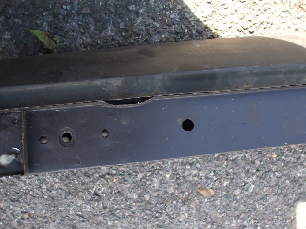

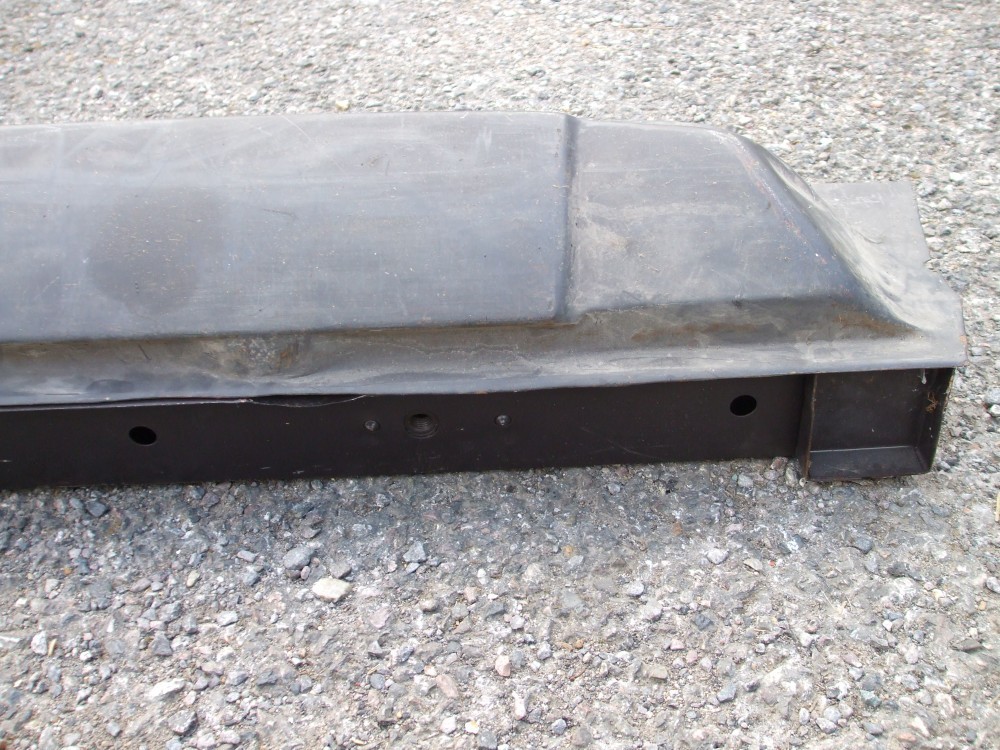

As has been stated above the OE Sills have three drain points along the joint between the inner and outer Sills, one towards each end, and one in the middle. Elements of the drains are included in the Sill inner and outer:
The inner Sill has indents as shown in picture 2

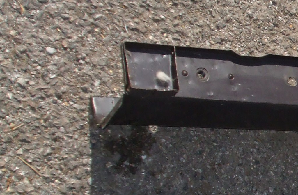

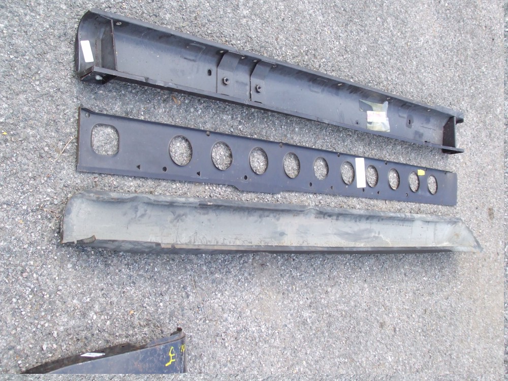

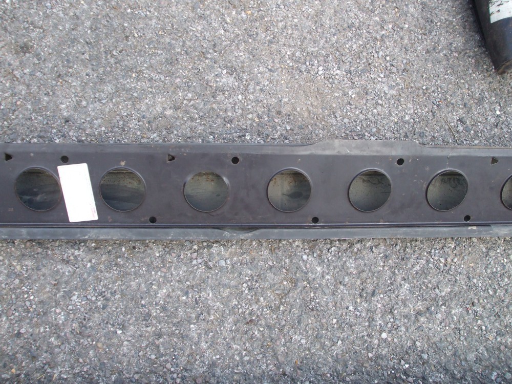

The OE outer Sill is not flat from the bottom of the radius below the doors to its flange, is it indented upwards on it's lower horizontal face except for the areas adjacent to the inner sill indents (as shown in pictures 3 & 4). This allows for a gap between the outer Sill bottom, and it's joint with the Sill Reinforcer as shown in picture 5. Non OE replacement Sills are flat in this area due to the limitations of the fabrication processes used for their manufacture.

- Sill reinforcer against outer Sill showing drain point
- Sill5.JPG (297.6 KiB) Viewed 3125 times
