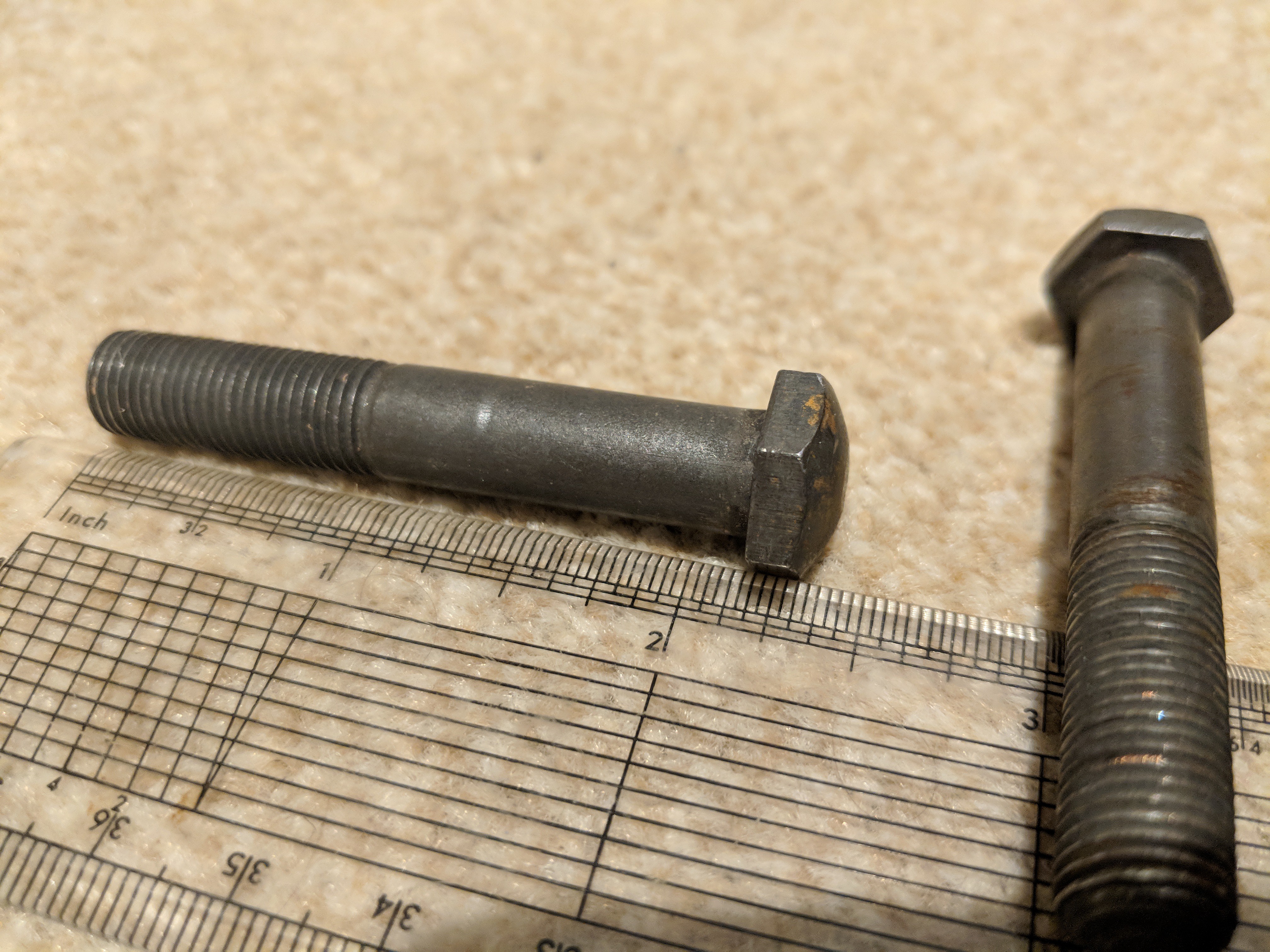

Some years later I'm on the same search for part 216901. I have no idea where the original is so I have little to go on. Helpfully the Toledo parts catalogue simply describe it merely as 'bolt'. I've read the entire thread through but there seems to be no solid conclusion. Ideas appreciated!

Thanks for the reply. Unfortunately I'm not sure where the original is - I'm trying to finish off an unfinished restoration project which was disassembled 25 years ago. It might be in boxes here, but identifying it is another matter! If anyone reading this has one and could take a photo of it next to a ruler that would be very helpful.

Thank you for all the replies. By some major miracle it looks like I've found some serviceable items in the spares stash. So I appear to be sorted for now, and at least I can document what they look like for the next person with this problem.
