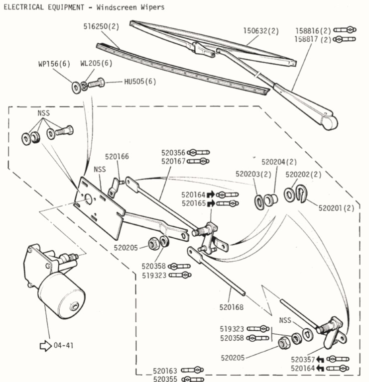

Sounds like you may have a tired motor that needs some new carbon brushes and the 40 year old solidified grease cleaning out and replenished. Even so, if it goes off the screen that means there is going to be a fair amount of wear in the linkage overall. Nothing too major but there are a fair few pivot points to wear over the years and add them all together and you'll get a lot of slop at the business end. I would take TrustNo1's suggestion and try wiggling them and see if a particular pivot has a lot more movement that the others. I'm only suggesting the motor might be tired because there is a lot of load on the motor when the mechanism changes direction hence stopping and needing a nudge when the blade also sometimes goes off the screen edge due to mechanism slop and wind push.

You can't even get to the wiring plug with the motor in situ! You can get to most of the linkage by removing the glove box and instrument panel, but the motor must be unbolted and disconnected from the linkage (from inside the car) then partially removed and turned to access the wiring plug before final removal for servicing.
If they are merely slow, the best course of action is to find out whether the problem is in the motor or linkage/wheelboxes by disconnecting the linkage at the motor and trying them separately.
