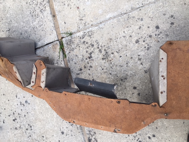

Where can I get the lower shelf material that is hardboard with a leather look finish?
Mine is just in bits and is in need of a rebuild, I have removed all the rivets and separated it ready for cutting from sheet material. I have the replacement rivets and made a setting tool for them.
Just stuck on this hardboard material.
Thanks
Thanks

I made a new parcel shelf from 3mm ply, using the old one as a pattern.
I covered it with leather-look vinyl stuck on with contact adhesive. I call it 'leathercloth'. I overlapped the steering column gap with excess vinyl flaps. These hidethe column better than the original.
I used the same vinyl stuff for the front roll, using the old foam.
The result looks great, and is more rigid than the original.
Peter.
Peter.

I have a mostly bespoke one here too, the base is ply, about 6mm thick with millboard sides and the whole lot covered in thin carpet. All the boot trim panels and the (plywood) rear parcel shelf with speakers in it have been treated the same way. All taken from a scrap car I bought some time ago. It may be non standard, but it LOOKS nice, seems considerably stronger than original and probably helps with noise reduction (in the boot at least)
I'm probably going to use the carpeted boot trims and rear parcel shelf on my own car (where originality is not a consideration) but the front parcel tray could be up for grabs as i'm making a bespoke centre console for it and deleting the knee knocker.

I took millboard and covered in carpet for my boot panels. Not original but looks so much better. I must admit I hadn't considered the rigidity of ply in a crash. I think I'll make another using millboard for the uprights. I still have 2 huge sheets.

Thanks for your input here guys.
I was toying with the idea of a ply sheet and covering it then I did think about the rigidity of it in a crash.
I might just do it all in millboard and put an extra trim piece around it or put the mill on top of hardboard.
Plenty food for thought either way mine is definitely FUBAR and only fit for patterns.
I'll keep you posted on the route chosen.
