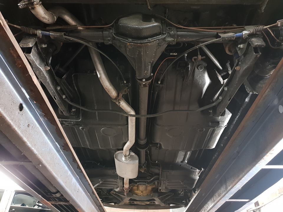

I found this photo on Facebook. Maybe it will help.
Sprint exhaust.jpg (96.39 KiB) Viewed 1176 times

Bumpa wrote: Mon Jan 14, 2019 8:53 am I found this photo on Facebook. Maybe it will help.
Thanks that is pretty much what I have done. Couldn't find the proper triumph clamp for the triumph rubber for the middle mount. Have to bodge that.
Like I said that never occurred to me, it looked so close to the propshaft, I was trying to root it down the nearside, which I now realise would have never have cleared the anti-roll bar.
Why did Triumph use that complex design with multiple turns for the standard system? it looks restrictive and expensive to make.
