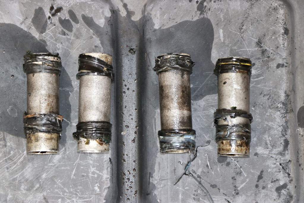

Three of my plug caps were swimming in an oil bath so I took a closer look.

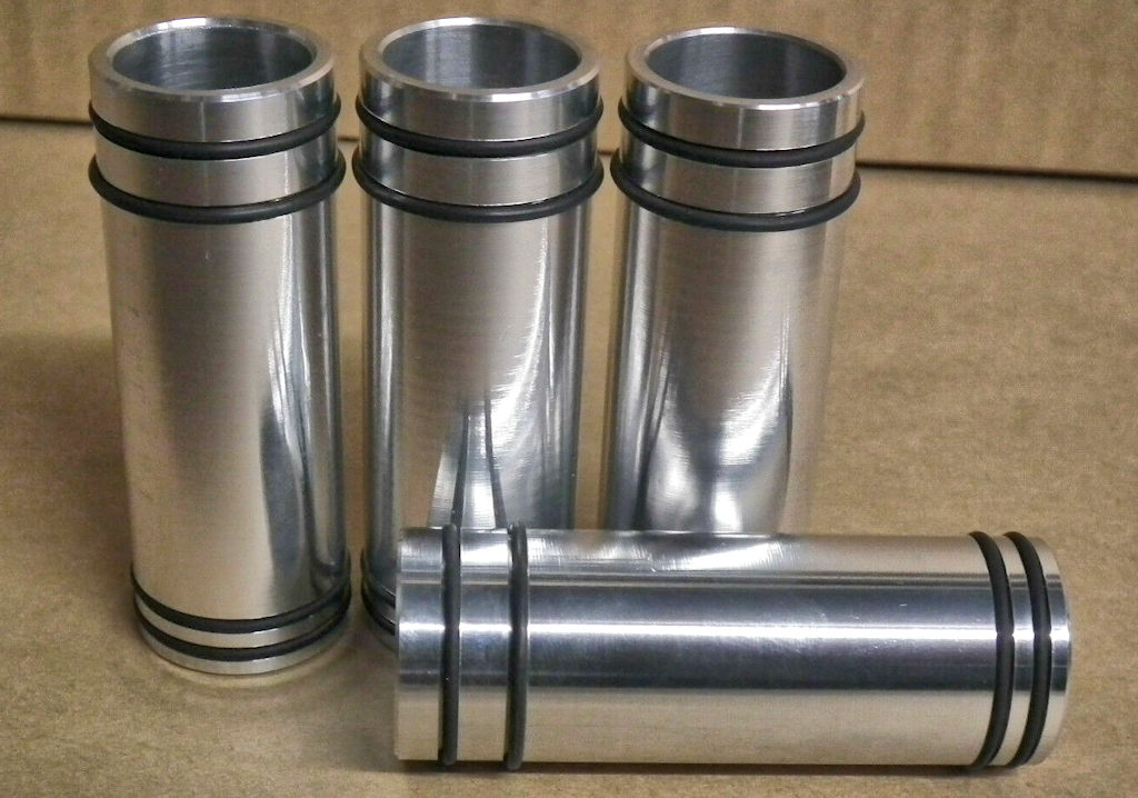

I replaced these with some O ring ones from Hans Martinsen via Ebay. These look to be of excellent quality, time will tell.
The spark plugs took a lot of shifting with a half inch drive T bar. They wouldn't budge with the 3/8 one. I put them back with a torque wrench set to just over 8 ft.lb so I'll check them again after a few miles.

I like the club ones, they have a step machined which locates them nicely.

The ebay ones are a cheap and nasty ripoff of the ones which we supply - except that the ebay oners are actually more expensive!!!

I have the club ones and they are brilliant. I've removed the cover probably 30 times since fitting and they just take it no problems.

The club ones have the shoulder, similar to the original style, which stops the tubes vibrating loose. If there is no shoulder then there is nothing to stop them working their way out through the cam/rocker cover (unless you bond them in with something).

The ones I have fitted use an extra protruding O ring ( just a shallower groove actually ) to prevent the tube moving upwards. I am sure the club design is well proven but there may be some merit in not over constraining the tube and allowing some self centering.

I recognise the ebay ones, didn't know the club ones were different. To be fair to them it does say in the instructions that they have two sizes of o-ring and that is how they are located.roadster wrote: ↑Tue Mar 19, 2019 3:52 pmThe ones I have fitted use an extra protruding O ring ( just a shallower groove actually ) to prevent the tube moving upwards. I am sure the club design is well proven but there may be some merit in not over constraining the tube and allowing some self centering.
