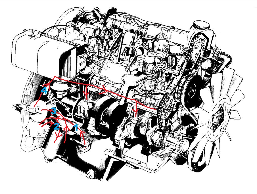

soe8m wrote: Sun Jan 05, 2014 9:27 pm That is the main gallery so oil into that.
Oil into that...in which direction? Is that the return from the oil cooler, or the feed?
I suspect that oil comes out of that port and into the oil thermostat and returns on the right when coming back from the OC....yes?
Re: Oil transfer plate, question
#18 Post by soe8m »
The red dot is the into the engine side.
#19 Post by soe8m »
Here you are.
#20 Post by shaunroche »
Excellent thank you, got there in the end.
