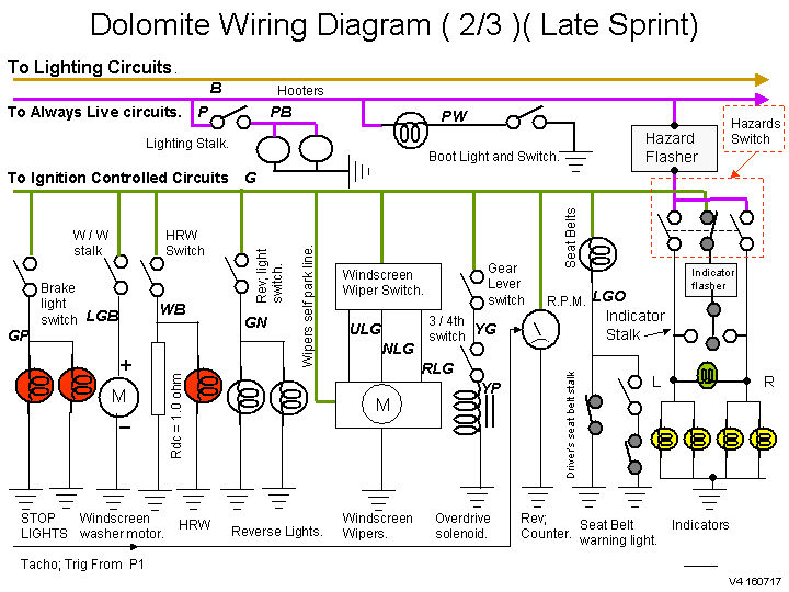

Just to illustrate the intricacies of the indicator / hazard flasher circuit this is the circuit of the system which does illustrate the switch functions and how the pilot bulb works on a late model Sprint.

So the indicator feed comes via the hazard switch and when the hazard switch is operated it cuts off the supply to indicators? So the hazards may work, but a fault with the switch could isolate the indicators?
- Posts: 7249
Re: Electrical question...
Exactly!
