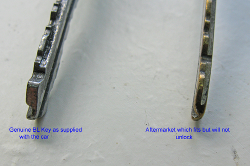

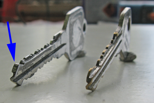

What intrigues me is the difference in the keys as you can see in the photo below. The key on the left is the ignition key for the Toledo. It is a British Leyland key and will be one of the originals supplied with the car. No other keys came with the car when I bought it. The boot did not have a boot latch fitted so I will be fitting one, with a matching glove box lock from some of the spares I hold here.
There is a subtle difference between the key on the left and a key which I picked out of my box of Dolomite keys, in this case, a (worn) copy of an original.
Look at the end of the key under the arrow and compare it with the key on the right. The relief which runs down the full length of the key on the right does not run to the end of the key on the left. You might see it a little more clearly in the second photo.
It is that lack of relief on the left hand key which prevents it from entering the door lock. Both keys will enter the ignition slot on the car although the key on the right will not turn. Likewise the key on the right will enter the door lock but will not turn.
I shall take the door lock and key on the left into a local locksmith next week and seek his comments.

When I looked back at some earlier photos I had of this car I spotted a bunch of keys hanging from the ignition with a distinctive medalion on the key ring. I remember spotting that medallion somewhere and in my search I found it and a bunch of keys. It included a spare ignition key and a round disc on which these markings were printed. On one face it said STEERING LOCK KEY SERIES NO. On the next line it said ESSENTIAL FOR REPLACEMENT. On the reverse face it shows the following; If I quote this number somewhere will someone will supply a new key? I have no idea where or who will do so. I have no need for another key at the moment for I had one cut to match the left hand key in the photo seen above which works satisfactorily.
On the same bunch of keys were two that actuate the door lock. It has a different pattern to the ignition key.
It seems that if when you try to unlock the car and use the ignition key the unrelieved end of the key will prevent it from entering the door lock. If you were fumbling around in the dark then you would just use the other large key on the key ring and that would open the car door.
That makes sense when you think about it and is quite a logical way of doing it, if as was the case with this car, the ignition and the door locks are keyed differently when the car was sold off the showroom floor.
