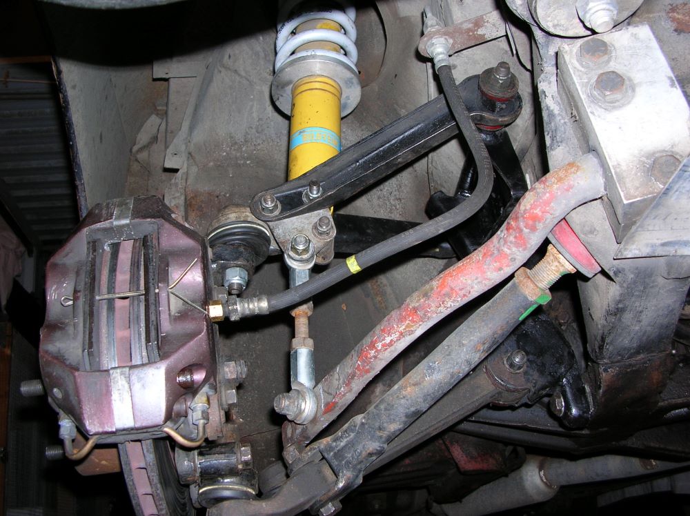

When you get a chance Geoff. Could you post some pictures of the front ARB

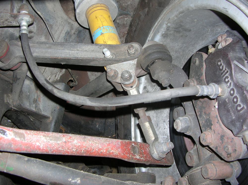

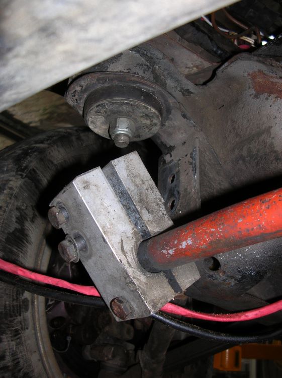

Pics as requested for front ARB
#5 Post by gmsclassics »
First shot shows the overall installation - same both sides. Note the modified plate for the top mount and adjustable tie bar. Adjustment to the ARB is made using 3 holes in the end of the ARB and by adjusting the length of the adjustable connector. Must admit when I got it handing right, I just left alone. The final shot explains the construction and installation of the ARB to the subframe.
First shot also gives you an idea of the brakes, Willwood calipers, vented rotors (BMW E21 323) and Ferodo DS3000 pads (Nissan Skyline MC).
Important note - these are old photos - make sure brake hoses are braided, not standard as in these shots
Geoff
