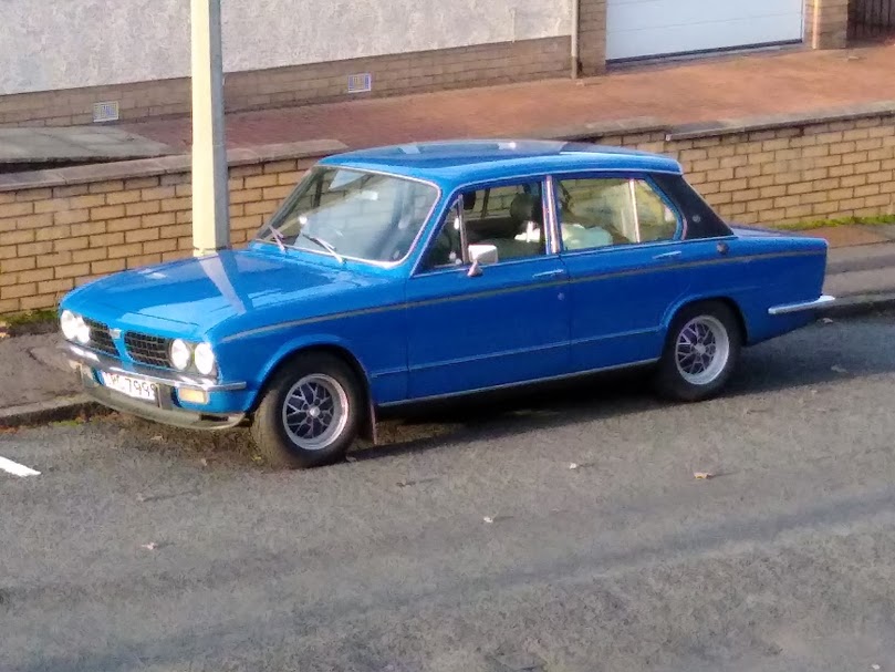

Very similar story to my 1850HL. Mine was owned by my brother-in-law from three years old, but was stored away in 1992 and not touched until I took it on about two and a half years ago. It only needed minor welding on the front of the sills and a repaint. Otherwise it is remarkable for a 42 year old British car. It is a delight to use, comfortable, fast enough for modern road conditions, and draws attention wherever it is parked. What colour is yours? Mine is Tahiti Blue.
At Maidencraig.jpg (99.62 KiB) Viewed 3616 times
