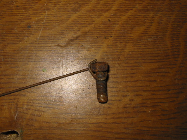

I have just spent an hour trying to get the rear bolt into the distributor mounting on my 1850 and all I have to show for my troubles is a badly grazed arm and a foul mood. I have lost count of the number of times I have dropped it to lodge somewhere out of sight. There must be a way of inserting it - whatever did the service agents do back in the day? I'm sorely tempted to really tighten the front bolt and leave the other one out. Please help. My sanity is at stake here.

Hi Mike, if you have any welding rod? (the old thin stuff) Make a holder to go around the bolt with a small piece on the top and you can guide it into place and still turn it with fingers until you get it in a few turns and then pull the rod off. If you cant grasp what i mean? Let me know and i do it to a bolt and send you a photo

Hi Tony, sounds like a plan. A photo would be helpful if you don't mind.

Hi Mike, you can use copper wire from 2'5 twin and earth if no welding rod. Just bend to shape.
Hope get the gist, it's a bit hard to explain.
- IMG_2307_1.JPG (109.09 KiB) Viewed 781 times
- IMG_2308_1.JPG (120.28 KiB) Viewed 781 times

Thanks gents. Tony, I see what you mean and I have plenty of old mains cable I can strip to give me a piece of copper wire. Roger, putting a point on the bolt is a good idea. My bolts are flat ended., but I know the threads are nice and clean and free running.

Tony, thank you, thank you. The trick with the loop of wire to hold the bolt worked like a charm and it is now in and tight. Phew! Hopefully I won't be removing that for a loooong time.
