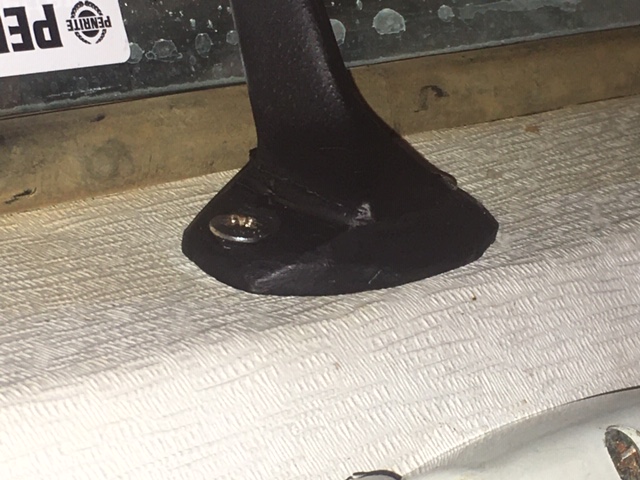

About 7 or 8 years ago after failing to repair my mirror mount with Araldite, I modelled a 'new' one around the ball on the mirror stalk from a product called Selleys Knead It Steel. http://www.selleys.co.nz/trade/speciali ... d-it-steel
While not perfect, it is black and in its shaded location looks no different to the original. No vibration or any other issues for example with adjusting the mirror itself.
Would it snap off in the case of an accident? I expect so but haven't tested that. But then it is a car with an ANCAP rating of one or below so I have to drive to avoid others accidents!
Geoff
Geoff
- IMG_1539 (002).JPG (121.06 KiB) Viewed 1703 times
