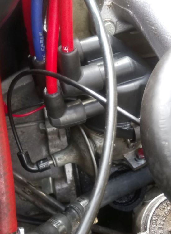

I’ve recently fitted an Accuspark Stealth Kit 5 (with rotor) for 45D4 along with a ‘Lucas’ side entry cap to my Mimosa Sprint. It all fitted under the inlet manifold allowing the full rotation of the distributor. At its closest the cap is about 2mm from the rearmost manifold bolt (even with spring washer on). It all seems to work fine and was so easy to fit. See photo.
I have a Magnetronic unit on my other Sprint (since 2011) but as in NZ the Accuspark unit was less than half the price I went with this one. Also used Magnetronic on the Sprint I raced for years without issue although I have heard via the Forum of others who have had problems.
Geoff
