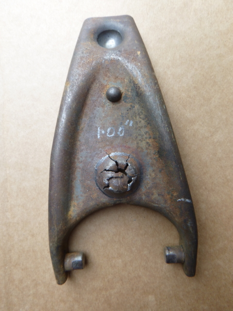

Just to give a yardstick on clutch operation the clutch slave cylinder push-rod should move about 15mm ( measured from mine ).
There is one weak point in the 1850 clutch. That is the release arm. The pivot point in the gearbox breaks through the release arm.
Here is one I broke earlier.
As I remember the part is common with Vitesse and GT6.
- 1850clutchfork.jpg (254.69 KiB) Viewed 440 times
